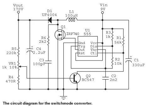

Method of generating 170 VDC to drive nixie tubes
In order to operate, nixie tubes need 170 VDC. I know that the mains voltage is 120 VAC-RMS. So if you account for the RMS value, 120*1.414 is nearly exactly 170 V. So would it be possible to make a full wave rectifier?
I decided to simulate the circuit in spice. If I use a 500 uF capacitor and a 1M bleeder resistor, I get a constant line at 170 VDC. The ripple is ~0 V.
My only concern is the stability of the components at such a high voltage. For example, I know diodes have breakdown voltage which apply to reverse current flow, but there may be other factors I'm not thinking of. And I'd also have to find capacitors capable of handing 170 V, although I dont think finding those should be hard.

I would be concerned about your safety. Think about using a switching power supply powered by a low voltage UL approved "wall wort".
Here's a simple 555 circuit kit which uses 9vdc from http://www.ledsales.com.au/kits/nixie_supply.pdf

Gloves are not the real answer to this.
The best solution is to never connect anything to the mains unless you can fully enclose the resultant system.
You can't depend on the neutral of the mains always being the neutral if the device is shifted.
Although we have all done it, there should never be exposed conductors with mains voltages (or any other high voltages) on them, even when testing the device.
Isolation transformers are relatively rare and expensive.
An alternative is to use two transformers back to back.
So, if you found a cheap source of identical 120 volt to 24 volt AC transformers you could join the two 24 volt windings together (ie in parallel).
Connect one primary to the mains and take 120 volts, isolated, out of the other primary.
Wall-warts (or plug packs) often have AC outputs and sell cheaply if the device they powered is no longer working.
You can develop low voltages for control circuitry from the low voltage ouput of the first transformer.
You still have to be very careful with the high voltage produced, but at least you can ground one side of it safely.
