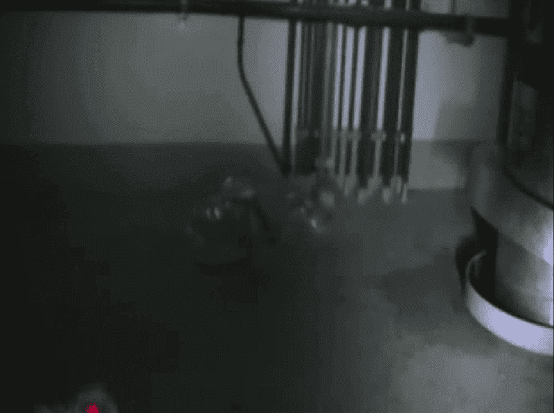

Quote Quote by clancy688 View Post
How thick is the door in question?
Judging from unit 2 video the door is not as thick as one might guess. Certainly it has a knob and can easily be opened (and more importantly closed) by hand. As I understand it this is not a door into containment, it's just a door to the torus room. While torus is part of containment the room in which it resides might not qualify as containment (ie if torus breaks then containment is breached). If that is the case then to get that pressure differential to bend the door (even if the door is not that thick) means a break either in torus or in one of the massive pipes that leads to drywell AND a pressure spike in the drywell.
Now normally the drywell has no oxygen (N2 atmosphere). However the explosion happened 3 days (if I remember) after power was lost which means there is ample time for some percentage of oxygen to seep in and react with the H2 from Zr-steam after venting. Another alternative that I see is a superheated bundle of metal falling all at once into a pool of water - no idea if the core (or a big chunk of) can possibly drop all at once to the bottom of RPV into water causing a steam explosion.
Not to beat a dead horse but I'd personally go with H2 explosion in drywell.

Quote Quote by shadowncs View Post
Um, it's not the first time I've posted the following document here (though jlduh provided it first), but it was mostly ignored. So, here again:
http://www.osti.gov/bridge/servlets/...Hq/5835351.pdf
"The impact of BWR MK I primary containment failure dynamics on secondary containment integrity."
A second potential mechanism for MK I primary containment failure
in an unmitigated severe accident is drywell liner (shell) ablation due
to direct attack by molten corium. The ability of molten metals to
erode steel structures is well documented.4 While significant uncertainties
surround the behavior of core/concrete reactions and corium
spreading in a MK I containment configuration,2 preliminary analyses
indicate failure of the MK I drywell liner is quite likely if core
debris does contact the inner liner surface5.
Should the liner fail near the drywell floor elevation, the most
probable sites for blowdown entry into the secondary containment are the
reactor building basement torus room
and the second floor of the reactor
building (Exhibit 2).
We probably do have some corium outside the pressure vessel, at least that's what TEPCO thinks, and this paper proclaims that under certain circumstances (corium attacks the drywell liner) a blowdown in the torus room is very likely.
On a second note:
If there actually is a hole connecting the primary containment with the torus room (either through drywell liner failure as explained above or torus damage), shouldn't the torus room be filled with water?
As far as I understand, TEPCO kept pouring water into the reactor vessels and containments until the drywell was filled to a certain height, so if there is a leak to the torus room, it should be filled with water as well.
Edit: Oh, tsutsuji already answered that question:
Quote Quote by tsutsuji View Post
http://www3.nhk.or.jp/news/genpatsu-...314/index.html On 14 March, a total of 6 Tepco workers went down to the basements and inspected the vicinity of the entrances of unit 2 and unit 3's suppression chambers. [...] It was confirmed that the 9 meter high suppression chambers in both units are partly submerged by 6 meter deep contaminated water.
Which spikes new questions for me:
First, where does the water come from? If shadowncs is correct and those chambers are secondary and not primary containment, then there have to be some containment breaches in either the torus itself or the drywell. Where else would the water come from otherwise?
And second, why are they only filled partially and not totally? If there are leaks and if there's water in the drywell (to cool escaped fuel) then I'd expect the lower lying chambers to be totally submerged and not only partially. Why aren't they?

And perhaps it is? In the vids you can clearly see both unit 2 and unit 3 lower-level basements are flooded at the stairwell. For unit3 vid the worker spends a large amount of time measuring radioactivity of the stairwell water, outside the torus room, which appears to be a few meters lower than the basement level the torus room door is located. That water comes from somewhere perhaps the most likely being the torus room. Remember those rooms are quite high. As to water in drywell, TEPCO is yet to confirm there is any water at all - see unit 2 endoscope. We simply don't know yet but I tend to agree, if the torus were intact then we'd expect water in drywell.
I'm surprised by the fact the unit 2 door could be opened, that with the "explosive sounds" reported coming from unit 2 torus early on.
Yes Im pretty sure that the water in the stairwell is the same as torus room water, because those stairs lead down to the floor level of the torus room (as opposed to the door they opened to look into the torus room, which is at least half-way up the torus room wall).
If neither the torus or the lower part of the drywell had damage then yes, we would expect to see much more water in the drywell, TEPCOs original drywell flooding plan would not have been abandoned. We can't use this to establish with certainty that the torus is damaged though because if the torus was intact but the bottom or lower walls of the drywell were damaged, we could still expect to see little water in the drywell and lots of water in the torus room.
As for the explosion at reactor 2, this has not been a safe assumption for a long time either. Firstly because the explosion at reactor 4 building happened around the same time, causing confusion, and later when they looked at local plant seismograph readings it looked like reactor 4 was the epicentre, not reactor 2. And the other reason they made a hasty assumption that the reactor 2 suppression chamber went boom, was because for many hours before the explosion they were afraid that the reactor 2 suppression chamber was in trouble. They knew its pressure & temperature was too high, but they failed in their mission to vent it, so they had to release more steam from the reactor into the suppression chamber anyway, because they were desperate to lower reactor vessel pressure so they could get some water pumped in. The site manager had already made plans for an evacuation, hours before the partial site evacuation actually took place. So with this in mind, its no surprise that when an explosive sound was heard and radiation levels on site climbed dramatically, they assumed the suppression chamber had failed.
And it may well have failed, all we can now rule out is that it failed in a manner where the torus was completely mangled, doors deformed etc.
The intriguing mysteries of reactor 2 only grow for me, because as we have seen from past surveys by humans & robots, there aren't the same sorts of highly contaminated areas at various locations within reactor 2 building that we see with reactor 1 (where various bits of equipment are well contaminated) or reactor 3 (where there were some very high levels of contamination to north-east and south-west of the drywell containment near to pipe penetrations and access doors). At reactor 2 we just have the highly contaminated water in the basement, and several hotspots on the refuelling level near to the concrete cap over containment, not much on any of the other reactor building floors with which we may gain clues about emission pathways.

Looks like a kind of unintended groundwater-corium-cooling-system to me. At least if any corium had reached the torus, it must have been cooled well by the groundwater inflow. Perhaps this is also one reason, why they keep the water level around OP 3000.
And if even the door to the torus room is damaged by the explosion in unit 3, I would expect severe damage inside the PCV too.
It will be an incredible effort to clean up this huge mess...

http://www.youtube.com/watch?feature...HEQ7IP0#t=388s
An impromptu blow out ring!
EDIT: make that two
http://www.youtube.com/watch?v=zfohH...ailpage#t=404s
LATER EDIT: Whatever it was, it was not inside those pipes. They look pristine. The overpressure came from below, from the 2nd basement level. Curiouser and curiouser.
