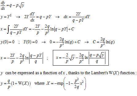

Hello,
Solutionof the ODE in attachment :
