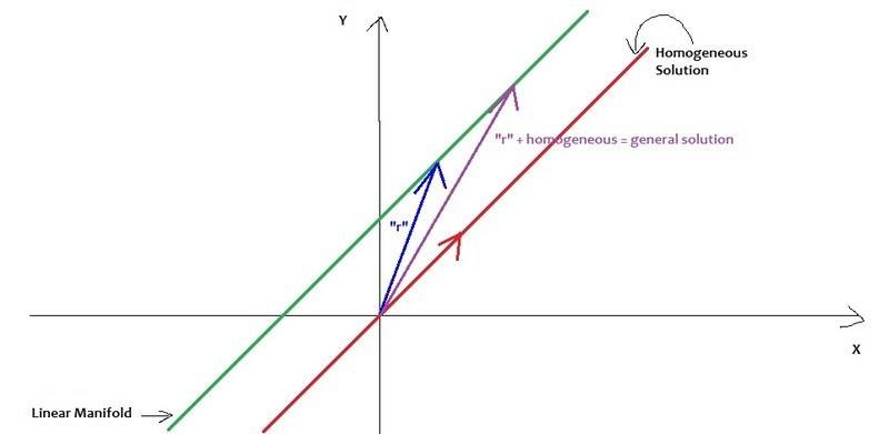

@ Stephen Tashi: That's actually something that I never thought about it. Interesting
@ HallsofIvy: Yes, that's exactly what I'm looking for. But I still don't understand how the homogeneous solution plus "r" would still form a subspace. It seems that adding the particular solution pops the solutions out of the subspace. I attached some pictures to show you how I'm thinking about this. If I drew that correctly then the general solution can't be multiplied by a negative scalar because it the line starts on the origin instead of going through it.

Well, the problem I have with answering this is that I just told you it doesn't form a subspace!
Your picture looks good. Yes, it is true that the general solution can't be multiplied by a scalar whether positive or negative (and give another solution) because the general solution does NOT form a subspace.
Apr22-12, 03:25 PM   #8
Oh, my mistake, that didn't make much sense because you explicitly said what is going on, lol. Subtracting "r" from the general solution would form a subspace, or that A' you were talking about earlier, which is the set of the homogeneous solutions. Thanks for your insight.
