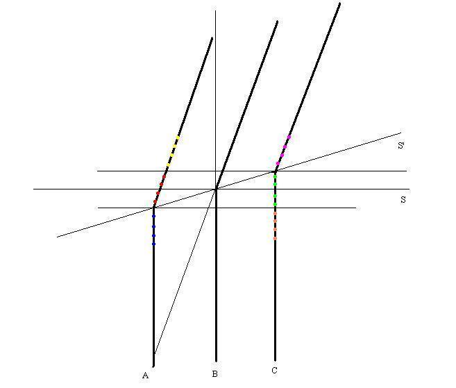

Quote by mananvpanchal View Post
Please look at below diagram.
The clocks changes its state from "rest" to "moving" unsimultaneously in S frame, and simultaneously in S' frame.
Now, we look the situation from the perspective of A clock.
Before changing state in S frame, blue events occurs on A clock, and orange events occurs on C clock simultaneously.
After changing state in S frame, red events occurs on A clock, and pink events occurs on C clock simultaneously.
Did you see green events on C clock is skipped for A clock?
Now, we look the situation from the perspective of C clock.
Before changing state in S frame, green events occurs on C clock, and red events occurs on A clock simultaneously.
After changing state in S frame, pink events occurs on C clock, and red events occurs on A clock simultaneously.
Did you see red events on A clock is reoccurred for C clock?
To solve the reoccurring and skipping problem, I have drawn the diagrams in post #20.
Please, read paper provided by DaleSpam in post #15 for detailed information.
Throughout this thread, A, B, and C were just clocks, not observers. Now you want to talk about their perspectives but this is an ambiguous term. Are you asking about what they can actually see and observe or something different?
In post #10, you introduced the idea that what you had previously called red and green events were actually light pulses. And now you have more different colored light pulses so are you now asking about what A sees of C's different colored light pulses and what C sees of A's different colored light pulses? There is only one answer to this question.
Or are you asking something different? If it is something different, then you need to specify exactly what that something different is because there are an infinite number of different questions with an infinite number of different answers and I have no way of knowing what you have in mind.
I couldn't understood the term "casual contact" before. And I still cant understand the term. What is meaning of "casual contact" or "directly observable"?
Two events along two worldlines are not causally connected if the proper interval between them is spacelike. This means that one of them is outside the others past light cone. In the 'now' of either event the other event will not be observable until 'now + later' of the observing WL.

No, I don't mean what observer see. When we are talking about some simultaneous events we don't worry about when the events will be observed. I am just telling that some events is simultaneous for some observer. that's it.
The blue and orange events are simultaneous for A observer.
The red and pink events are simultaneous for A observer.
The green and red events are simultaneous for C observer.
The pink and red events are simultaneous for C observer.
What you are doing is implicitly selecting the frame in which the observer is at rest. This can work unambiguously for three of the four cases you presented above because both the observer and the remote clock are at rest in the same frame and therefore we can talk about light pulse events being simultaneous. But it doesn't work unambiguously for the third case because C observer is not at rest with respect to A clock during the time interval of the green events. If you say that the pink and red events are simultaneous in S frame, then, of course they are simultaneous for C observer in his implied rest S frame but now you are forcing the red and green light pulses to occur at different time intervals in their own rest frames without any way to co-ordinate the timing intervals of the two sets of clocks.
You stated in post #3 that you wanted the clocks to emit light pulses at regular intervals of time and your drawing in post #31 appears to show that. The problem is that as soon as A clock changes speed and before C observer and C clock change their speed, there can not be any more simultaneous light pulse events between clock A and observer C with his clock C because the clocks are ticking at different rates. And the only way that we can say that the light pulse events after C observer/clock change their speed are simultaneous is if they happen to be simultaneous with A clock and we ignore the fact that the times on the clocks are no longer ticking synchronously in their common rest frame.
But you said earlier that you weren't concerned about these issues, you were only concerned about the simultaneity of events. Please go back and look at yuiop's post #7 where he illustrated these issues perfectly and your discount of his post in your post #10.
You can't have it both ways, you either care about the timing on the clocks which cause the light pulse events to be simultaneous or you don't care about the timing on the clocks and simply define arbitrary events to be simultaneous in the two frames.
One more thing: you set up your scenario in such a way that the three clocks started out at rest in the S frame and then you stated that they change speed simultaneously in the S' frame to become at rest in the S' frame. How did each clock know when to fire its rocket (or whatever) to cause this simultaneous change in speed in the S' frame?

Quote by ghwellsjr View Post
The red and pink events is occurred simultaneously in S' frame not in S frame.
Yes, I have stated that the events is occurred at some unit time interval. But, that was over requirement to explain the problem. To explain the problem I actually don't need events occurred at some unit time interval, I don't need readings of clocks, I don't need to bother about synchronization of the clocks.
As I said before events has nothing to do with timings of clocks.
Clocks don't know, I know that when to fire its rocket. I have showed this in diagram that when I have fired its rocket.
See, I had a problem which is solved. But, I cannot understand what is your problem.
Do you not agree with problem?
or
Do you not agree with solution?
