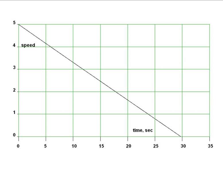

Here is a plot of your car deceleration using a Crr of 0.017. There is no curvature. If I add air drag, I see no effect until the drag coefficient is over 1. Stokes (linear) air drag may apply at these speeds. How level is your track? A change in slope of 0.1% makes a difference.
I can't deny that there might be a slope of 0.1%, but it should be more or less as level as it can be... So you might recommend us doing calculations at higher speeds?
Yes, if you just use Crr there won't be any curvature. Can you tell me how you made the calculations/graphs using both rolling and air resistance, and tried changing the drag coefficient?
Apr24-12, 10:54 AM   #11

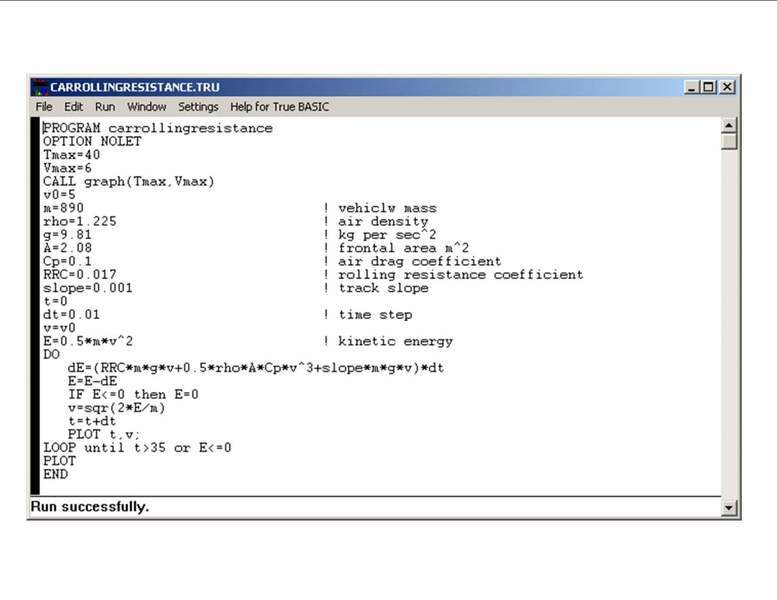

I used The program shown in the attachment (written in True Basic). A slope of 0.1% (1.2 inches per 100 feet) in your track is equivalent to changing your Crr by 0.001 ( i.e., from 0.016 to 0.017. You might run the test in the opposite direction, or using a different section of track. Higher speeds will make the turbulent air drag larger, and use a larger section of track, but running test in both directions will decrease the dependence on slope.
