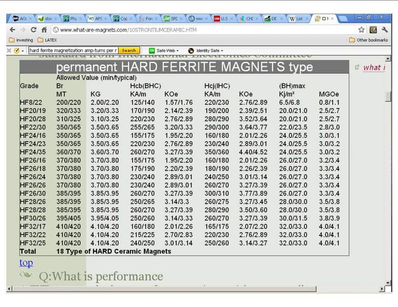

Are you talking about a toroidal "refrigerator" permanent magnet made of "hard" ferrite? You will need up to 300,000 amp-turns per meter. See attached table from http://www.what-are-magnets.com/10STRONTIUMCERAMIC.HTM
