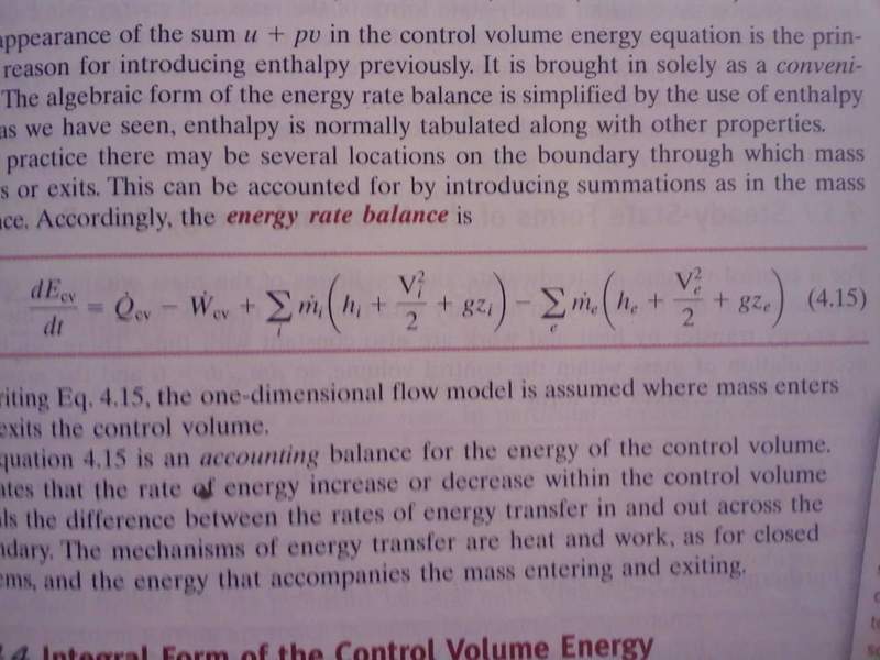

Hi
I'm referencing Fundamentals of Thermodynamics, by Moran and Shapiro. I think the formulation you gave is the same as mine, except W is moved over to the other side and enthalpy, KE, and PE are added

Hi
I actually had a typo, the Usystem should have been an Esystem; in Moran and Shapiro Esystem includes KE and PE of the system but this doesn't really address your question. I have posted the equation, which is written in terms of the rate of change of the energy in the system. The KE and PE presented in the text represents the KE and PE of the flow in and out (which is the basis of my question), while PE and KE of the system are included in the dE/dt term.
Thanks

This is not a statement of the first law of thermodynamics. The first law of thermodynamics deals with thermodynamic changes between equilibrium states.
Your text is dealing with the energy balance in a dynamic fluid flow ie. a system that is not in equilibrium. Those little dots above the m, Q and W refer to the first time derivative of these quantities.
This question has to do with fluid dynamics. The Bernouilli equation deals with conservation of energy in dynamic fluid flow. The first law deals with conservation of energy in between states of thermodynamic equilibrium. This equation appears to combine Bernouilli's equation and the first law of thermodynamics for a dynamic flow in which heat flow and thermodynamic work occurs.

Hi
I think the differences is a semantic issue. In the thermo course I took the prof actually used what the author had but took out the dots/time derivative so it became a pure energy balance rather than a rate balance that accounts for flow and called it the first law, which he used synonymously with energy balance. Now I know that he may have came up with his own version of first law and not the standard definition, but I think both would work fine in an application.
So now that's cleared up, I'm wondering if you can answer some of my question in the OP. Specifically, I'm confused on what the difference between flow work and kinetic energy of the flow is and what stagnation state really is?
Thank you

It is not a semantic issue. What you have stated is NOT to be confused with the first law of thermodynamics. Your equation applies to non-equilibrium states ie. fluid flow. The first law of thermodynamics deals with systems in different states of thermodynamic equilibrium.
Thank you
You should post this as a fluid dynamics problem re: stagnation flow.
Thermodynamic work is δW = PdV. Kinetic energy of the flow, dKE = (dm)ρv^2/2. If the system is a flowing fluid and there is heatflow into or out of the fluid, to account for all the energy in the system you have to account for both.

PV is not to be confused with PΔV. PV describes a particular state of pressure and volume - it represents a form of energy or ability to do work. PΔV relates to a transition between two states in which work PΔV is done at constant pressure.
So regarding the first law again, it seems that my understanding beforehand was completely wrong.
In Moran and Shapiro they say that first law is used to describe a thermodynamic cycle, but within the control volume that contains the cycle, there are fluid flow, so how come this system (a control volume that encompasses the whole cycle) can be analyzed by first law? Is the way I define the system determine whether first law can be used to analyze it or not?
The first law applies to determine the change in internal energy, heat flow and work done in a transition between two states of equilibrium of the system.
In the case of a closed piston cylinder with a gas, if I only take a control volume of half of the cylinder, can I still analyze the energy balance with first law? How would I identify whether first law or the general energy balance equation applies for a particular situation, you mentioned that first law only applies for a system with two end states in thermodynamic equilibrium, I can only think of closed systems that satisfy this is this correct?
If the piston moves slowly, you can analyze everything using the first law. In that case, the mechanical (kinetic) energy of the gas and piston will be negligible. If the mechanical energy of the system and control volume is not negligible, you have to account for it using the kind of equation in your text.

Because the first law applies to transitions between states of equilibrium. So if it is moving slowly (ie. so the rate of energy change due to the incoming and outgoing mass is negligible) the first law will account for all the changes in energy.
The equation that is set out in your text says this:
change in total energy = heat flow into the control volume - work done by the control volume + (enthalpy of the incoming mass + kinetic energy energy of incoming mass + potential energy of incoming mass) - (enthalpy of the exiting mass + kinetic energy energy of exiting mass + potential energy of exiting mass).
If you only have the control volume (no incoming or outgoing mass flow), you are left with just:
ΔE = heat flow into the control volume - work done by the control volume = Q - W, which is the first law.
AM
