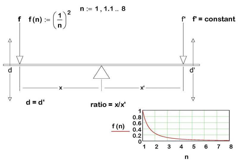

I need to design a cam based on the following math problem: A non-linear force f(n) is working on a lever that is x + x' long (x+x'=constant). I need an equation for the ratio, x/x', such that the counter-balancing force, f', is constant (non-varying).
By varying the ratio of f(n) to f', that is ratio=x/x', I should be able to find an equation describing the ratio (r) that provides a non-varying output force f'. The distance that f(n) works through is the same as the distance that f' works through, so work in = work out.
Any help will be greatly appreciated. I don't know quite how to approach this problem.
I hope the attached jpeg expalins the problem in enough detail

Your solution works where both f and f' are known. If you know f' and f you can find x, and then f' = f*x/(C-x). But you need x to find f' and you need f' to find x.
I believe I have found a solution: It is required that the distance traveled for f and f' be equal. Work is equal to force times distance, so if distance is equal and f is a function of n, then the work done by f is [itex]\int f(n) dn[/itex]. This yields a constant value for the area under the curve of f(n). So now the ratio(n) (which is x/x') is equal to([itex]\int f(n) dn[/itex])/f(n)*n. Then f'(n) is equal to f(n)*ratio(n), and f'(n) is constant.
The net result is that the ratio varies as f(n) varies to maintain a constant counterbalance force f'.

A lever that is x+x' long has a force f on one end and a countering force f' on the other end and the fulcrum is at a position determined by x, x'. Say x = x', then the fulcrum is in the center and f must equal f'. This just a simple lever and the distance that f moves will be equal to the distance f' moves.
Now you can vary the relationship between x and x' such that the fulcrum moves to the left or right of center. The ratio x/x' will be equal to the ratio f/f' and the distance each force moves the end of the lever s/s'. Again, simple lever physics.
But lets make f a function (it could be any function) such that f becomes non-linear. Let's say the function (call it 'n') is exponential. In my example, f(n)=(1/n)2. But it could be any function - that part is not important. Just that the force is non-linear. Now, if you have a fixed positon for the fulcrum (that is, x and x' are non-varying) then the countering force f' is simply f(n)*x/x'.
My problem is to find a function so that x/x' becomes non-linear and yields equal work, wf=f*s = wf'=f'*s' and f' is constant and stotal = s'total.
s is not equal to s' at all moments in time since the ratio, x/x', is varying. If area under the curve f(n)(that is, its integral) is made equal to the area under the curve (straight line) for a non-varying f', then work done on both sides will be equal and the total distance traveled on both sides will be equal.

f becomes a non-linear function of what? Distance travelled? Time? It means nothing to say f is just 'non-linear'.
Perhaps you mean non-constant, so f = f(t). The ratio x/x' = r(t).
Since f' constant, r(t) = f(t)/f'.
The deltas to distance moved must be in the same ratio: ds = r(t).ds'
(Check: work is conserved at all times: f(t).ds = f'.ds')
The remaining constraint is
∫.ds = ∫.ds' over the range of t. I.e.
∫r(t).ds' = ∫.ds'
We can reparamaterise r as a function of s':
∫r(s').ds' = ∫.ds'
I.e. the average value of r(s') as s' varies is 1.

I'm sorry - I did make it more confusing by saying that force f was a function of n where n is a series and f(n)=(1/n)^2. The force does vary as a function of time (time is proportional to n).
