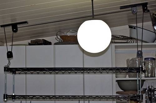

Hello from a non-engineer. This post has a very practical purpose:
I'm about to move into a small loft apartment with high ceilings but limited living and closet space. I'd like to find some way to mount a pipe to the ceiling via pulleys and rope or cable that can be lowered and raised with a hand crank. My dilemma is how to keep the pipe level, since I'd like to use only one hand crank.
I've looked at a setup something like this (a repurposed bike rack), but I can only imagine that it could be difficult to keep a heavy rack of clothes level while raising and lowering it.
Any suggestions? (Thanks for the help).

Welcome to PF, Loudpipe.
I am also not an engineer, but I have a thought. If you use a separate cable for each end, both attached to the same reel, they have to take up and play out at the same rate. Assuming no glitches in the pulleys, that should force it to remain level.
I agree. That would work. I was hoping to avoid the potential mess of having two cables run onto one spool though. The other thought was using two spools, and use gears so only one handle is required, but I don't know if anything like that exists, and I don't have the means to machine it.
A slight variation to that idea works better. I've used it in many material handling designs. Use two ropes, but attach them to a third rope that terminates on the hoist drum. Or the first two ropes can be one rope with each end attached to opposite ends of the rod. The idea in this picture won't do what you want it to do. That is how you rig it if you want to adjust the angle it hangs at, not to keep it level.
Are you advocating something like this? I could see it working if wires were put on either side to apply tension and keep it balanced, something like you typically find on either side of a garage door. (Do those have a specific name?) Otherwise I think the racks could slide down and cause it tilt strongly to one side.

Getting close. The ropes attached to each end of the rod must go straight up, each to its own pulley. Then you can route them through as many pullies as you need to bring them together at a common location. At that point you tie them together and connect them to the hoist line. It works well for the first two lines to be a single piece of rope. Then form a bight in it and connect the hoist line with a double sheet bend.
I found all the parts you need in the rock climbing section of the Campmore web site. I'd recommend a kernmantle static line. Good wear resistance with little stretch. Also works well with a sailboat cam cleat to secure the line.
