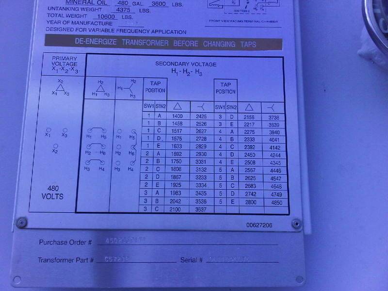

Jun7-12, 07:59 AM   #13
So far I have found these specials transformers are used almost on Off Shore Aplications, Siemens, GE and Scheneider have some experience already.
They are using a Topside Transfomer (Boost up) and a Subsea Transformer (Boost down)
Drives still are Topside.
See atatched picture of one unit (Topside)
According to some manufacturers the size of these "special" transformers is 10 to 15% bigger than standard ones.
