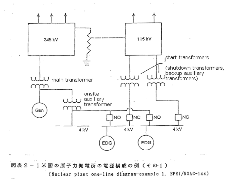

Some more translation. http://www.nsc.go.jp/info/20110713_dis.pdf page 2-4 (4/96-6/96).
2. Positioning of full AC electric supply loss events (SBOs) in foreign countries and present status, etc.
2.1. Positioning and management of SBOs in foreign countries' regulations, and present status of plant design in foreign countries
2.1.1. United States
(1) Positioning and management of American SBO regulations
The Reactor Safety Study published in 1975 showed that SBO is an important contributor to core damage frequency, and made clear that the reliability of American emergency AC generators was not as high as had been presumed until then.
For that reason, in 1979, the Nuclear Regulatory Commission (NRC) designed SBO as Unresolved Safety Issue (USI) A-44, and started in July 1980 to study whether new regulatory requirements must be carried out.
In June 1988, the NRC published NUREG-1032, containing a technical evaluation of SBOs with evaluations of loss of offsite power frequency and duration, emergency AC generating systems' reliability, etc.. In it, it was said that it was desirable to keep SBO generated core damage frequencies below 10^-5/Reactor*Year and concluded that each nuclear power plant should possesses enough resistance so that a 2~8 hour long SBO would not lead to core damage. In reaction, adding 10CFR50.63 : "Loss of all alternating current power" (mentioned below as "SBO") to the Code of Federal Regulation, the NRC made a legal requirement to assess if enough resistance is provided against SBO, or if countermeasures such as installing backup AC power supplies are necessary. Also, the Regulatory Guide 1.155 (mentioned below as "RG1.155"), which details how the NRC staff concretely assesses resistance against SBO, was published in August 1988.
On the other hand, the Nuclear Utility Management and Resources Council (NUMARC) which is a federation of power companies and reactor makers, compiled NUMARC-8700 containing an assessment procedure even more detailed than RG1-155. The NRC staff reviewed NUMARC-8700 and approved the method contained in it.
Using the NUMARC-8700 procedure, each nuclear power plant owning American power company submitted an SBO assessment to the NRC by 17 April 1989. These were reviewed by the NRC which approved the companies' plans to change equipments or manuals at about one half of the plants, instructing them to do so within two years. Eventually, the equipment and manual changes should be completed by the end of 1994.
(2) Outline of present status of American plant design and operational management
The construction of American nuclear power plants' power supply systems varies from plant to plant, but basically they are as shown on figures 2-1 and 2-2 [http://www.nsc.go.jp/info/20110713_dis.pdf 32/96-33/96].
Many American plants are connected to the grid via two different voltage transmission lines. In normal time, onsite loads are supplied via auxiliary transformers connected to the main generator. When the reactor is started and shut down, they are supplied via the start transformers (also called shutdown transformers or backup auxiliary transformers). The safety related systems and equipments are supplied according to the operators' choice between the onsite auxiliary transformer, the start transformer or the EDGs. In the case where for example the main generator trips and power cannot be supplied by the onsite auxiliary generator, the safety related systems and equipments are automatically switched to the start transformer or EDG. The priority between start transformer and EDG varies between plants. In the case where there are several start transformers, that too becomes backup. In the case where all offsite power is lost, EDGs start automatically, and safety realted systems and equipments are supplied.
In the case the resistance against SBO specified in RG1.155 is not met, the compulsory installation of backup AC power supply specified in SBO regulations consists of an onsite AC generator or one which can be supplied from a location close to the plant. Concretely, it is as shown in the following examples: on single reactor sites, they install an EDG not belonging to the emergency partition, or power equipments receiving power from an offsite thermal or hydraulic power plant. On multiple reactor sites, there is a cross tie between emergency busses. Examples are shown on figures 2-3 and 2-4 [http://www.nsc.go.jp/info/20110713_dis.pdf 34/96-35/96].
The operation management of American nuclear power plants is regulated by the technical specifications. We present below the outline of operation management of electric systems as regulated in standard technical specifications for an undetermined plant.
1) EDG surveillance
① starting test without load
It consists of verifying that the specified revolution speed, generated voltage, frequency are secured 10 seconds after a manual start signal or a mock-up loss of offsite power signal.
② continuous test with load
Performed without break after the starting test, it consists in verifying that synchronization and specified voltage are secured within 60 seconds and that it can keep running that way for at least 60 minutes.
③ EDG test frequency
The frequency of starting tests without load and continuous tests with load depend on past test results. If the past 100 tests generated 0 or 1 malfunction, tests are performed at least once every 31 days. In the case of 2 malfunctions, at least once every two weeks, In the case of 3 malfunctions, at least once every week. In the case of 4 or more malfunctions, at least once every 3 days.
④ EDG tests during reactor shutdown
In addition to the above mentioned starting tests without load and continuous tests with load, some tests must be performed at least once every 18 months during reactor shutdown. The main ones are a 24 hour test with load, a breaking test with load verifying the circuit breaking capacity, an automatic introduction test verifying load break and connection by a load sequencer during loss of offsite power, etc. Moreover, a simultaneous start test verifying the separation and independence of 2 EDGs is performed at least once every 10 years. 2) Inspection of DC power supplies such as batteries
The following inspections are performed on 250/125 V batteries and battery chargers:
① Inspection performed at least once every week
check of electrolyte surface in representative cells, voltage check, specific gravity measurement.
② Inspection performed at least once every 92 days
check of electrolyte surface in every cells, voltage check, specific gravity measurement, mean temperature of 6 cell electrolytes, voltage inspection of the battery as a whole, electric current inspection during floating charge.
③ Inspection performed at least once every 18 months
visual inspection of every battery cell, terminal board, rack, etc., visual inspection and measurement of resistance of connection lines between cells, 8 hour long charging test.
④ Inspection performed at least once every 18 months during reactor shutdown
8 hour long connection to real load to test electric power supply capacity.
⑤ Inspection performed at least once every 60 months during reactor shutdown
Discharge test.
2.1.2. Germany

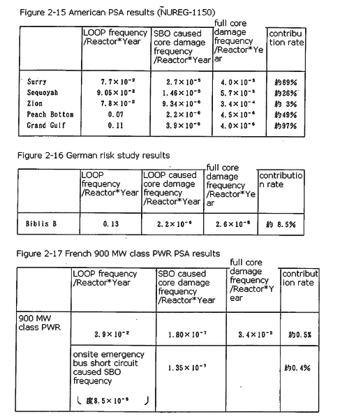

2.3.4. PSA results
In PSA, generally an event tree is created assuming loss of offsite power as causal factor, then the emergency power system suffers either a starting failure or a continuous operation failure, and in the case where there is a SBO as a result of offsite power not being restored, a modelization describes how it leads to core damage. Core damage frequencies vary much in function of how far one considers the offsite power restoration and the operation manual. In PSA, it is necessary to pay attention to the fact that these matters differ according to plant design and to the analysts' jugement, etc. We present below the core damage frequencies obtained in PSA results in foreign countries, limiting them to those generated by internal causes.
① United States
In 1990, the NRC published its final PSA report, NUREG-1150, concerning 5 nuclear power plants. NUREG-1150 deals with the PSA of 3 PWRs (Surry (WH 3 loop, negative pressure PCV, 788 MWe output), Sequoyah (WH 4 loop, ice condenser PCV, 1148 MWe output) and Zion (WH 4 loop, dry PCV, 1100 MWe output)) and 2 BWRs (Peach Bottom (GE, BWR-4, Mark-I PCV, 1150 MWe output) and Grand Gulf (GE, BWR-6, Mark-III PCV, 1250 MWe output). While general data about causal factor frequencies and equipment failure rates are presented, in each plant's analysis they are quantified using the data specific to each plant reflecting each plant's operational experience. In general data, the loss of offsite power frequency is 0.1/Reactor*Year. The loss of offsite power frequencies and core damage frequencies have been collected for the 5 plants in figure 2-15 [http://www.nsc.go.jp/info/20110713_dis.pdf 58/96]. ② Germany
The German reactor safety association (GRS) did a risk study divided into two periods for the Biblis B plant (German PWR, 1240 MW). The first period is up to 1979 and the second period up to 1989.
In the second period study, the frequencies of abnormal transient changes during operation including loss of offsite power were estimated using Biblis B's operational experience. The loss of offsite power frequency was estimated to be 0.13/Year, and the core damage frequency generated by this was estimated to be 2.2 10^-6. It contributes to 8.5% of the full core damage frequency induced by internal causes, which is 2.6 10^-5. In the first period study, the contribution of loss of offsite power to full core damage was 15%. The difference is caused by design changes performed at the end of the first period. Loss of offsite power frequency and core damage frequency are shown in figure 2-16.
③ France
In France, where reactor standardization is progressing, two PSA have been performed concerning two standard reactors, the 900 MW class and the 1300 MW class. A characteristic of those analysis is that beyond the normal causal factors generated during power generation, an analysis was also carried out including when the reactor is in shutdown status. In order to compare with the other countries, we present below only the results of the 900 MW class reactor PSA performed in 1990 by French Atomic Energy Commission (CEA)'s nuclear protection and safety institute (IPSN).
As SBO causing events, the loss of the main (400 kV) transmission line alone (frequency: about 0.3/Reactor*Year), the simultaneous loss of the main transmission line and the auxiliary transmission line (225 kV) (frequency: about 2.9 10^-2/Reactor*Year) and the failure of one EDG (frequency: about 6.85 10^-4/Reactor*Year) are evaluated. However, as these events alone do not contribute to core damage, when 2 more onsite EDGs fail (frequency: about 1.81 10^-5/Reactor*Year), it leads to core damage with a frequency of about 1.80 10^-7. Also, apart from those loss of offsite power causes, they evaluate full loss of AC power caused by onsite emergency bus short circuits (frequency: about 8.47 10^-5/Reactor*Year) leading to a core damage frequency of about 1.35 10^-7. According to that study, the contribution of SBO to the internally caused full core damage frequency (3.4 10^-5) is extremely small. Loss of offsite power frequencies and core damage frequencies are shown in figure 2-17.

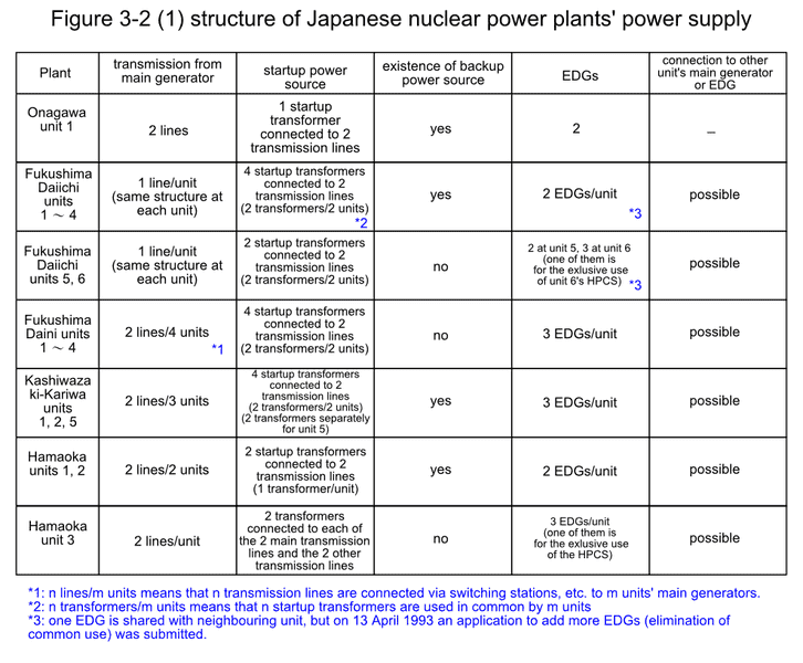

(1) power supply structure and plant design
In nuclear power plants, during normal operation, the electric power generated by the main generator is sent to the utility grid via the main transformer, and in order to supply onsite normal loads etc., a part of the electric power is supplied to the normal bus, etc. via the onsite transformer. Also, in order to supply electric power during plant shutdown, startup transformers are installed and designed so that power from the grid can be supplied to the onsite normal and emergency buses. These electric power structures vary from plant to plant, but in Japanese nuclear power plants, due to the requirements of the Regulatory Guide for Reviewing Safety Design, the nuclear reactor facilities are connected to the offsite power system by at least 2 transmission lines, and the design provides that emergency buses can be supplied from the grid. Additionnally, in some plants, power from the grid can also be supplied via a backup power transformer.
Even in the case when power cannot be supplied like this by offsite power, emergency onsite power supply systems are installed, so that the emergency buses, to which engineered safety systems can be connected, are supplied. In Japanese nuclear power plants, due to the requirements of the Regulatory Guide for Reviewing Safety Design, the emergency onsite power supply systems are required to have redundancy or diversity and independence. For that reason, in every plants there are at least 2 independent emergency onsite power supply systems, and each system is equipped with an EDG. However, in part of the BWR plants, in some cases, one of the 2 EDG systems is for the common use of 2 plants. Also, DC power supply systems consisting in batteries, chargers, etc. belong to the emergency onsite power systems and they supply loads such as the control of turbine driven pumps (the turbine driven auxiliary feed water pumps of PWRs, the RCIC (reactor core isolation cooling system) of BWRs), monitoring of reactor status, emergency lighting, etc..
On the other hand, in plants having a neighbouring plant, some of them can borrow power from the neighbouring plant.
Please note also that in order that nuclear reactor facilities' safety is not harmed by earthquakes, based on "Regulatory Guide: Reviewing Seismic Design of Nuclear Power Reactor Facilities" (NSC decision of 20 July 1981) [ http://www.nsc.go.jp/NSCenglish/guides/lwr/L-DS-I_02.pdf ], etc., emergency onsite power supply systems are required to be designed as seismic resistance class As equipments, and turbine electric generators as seismic resistance class B or C. Also, switching equipments must be designed in accordance with Japan Electric Association's "Regulatory guide for seismic countermeasures of electric equipments in transformer substations, etc." (May 1980).
Furthermore, in order that nuclear reactor facilities' safety is not harmed by fire, based on the "Regulatory Guide for Reviewing Fire Protection of Light Water Nuclear Power Reactor Facilities" (NSC decision of 6 November 1980, revised on 30 August 1991) [ http://www.nsc.go.jp/NSCenglish/guides/lwr/L-DS-I_03.pdf ], reactor design must notably adequately combine the 3 following measures : ① fire prevention (design using as far as possible non burnable, or hard to burn materials, etc.) ② fire detection (installation of suitable fire detection devices, fire extinguishing systems. Design must ensure that the safety functions of systems and equipments that are important for safety are not lost by wrong activation of the fire extinguishing system) ③ reduction of the consequences of fire (design must build countermeasures to reduce de consequences of fires in the areas neighbouring the areas where systems and equipments that are important for safety are installed).

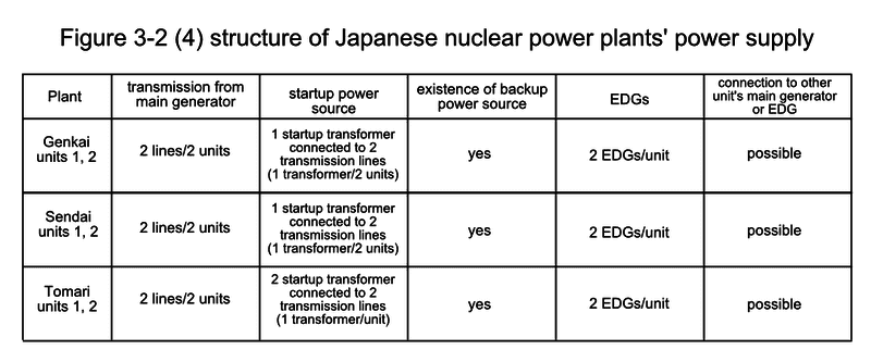

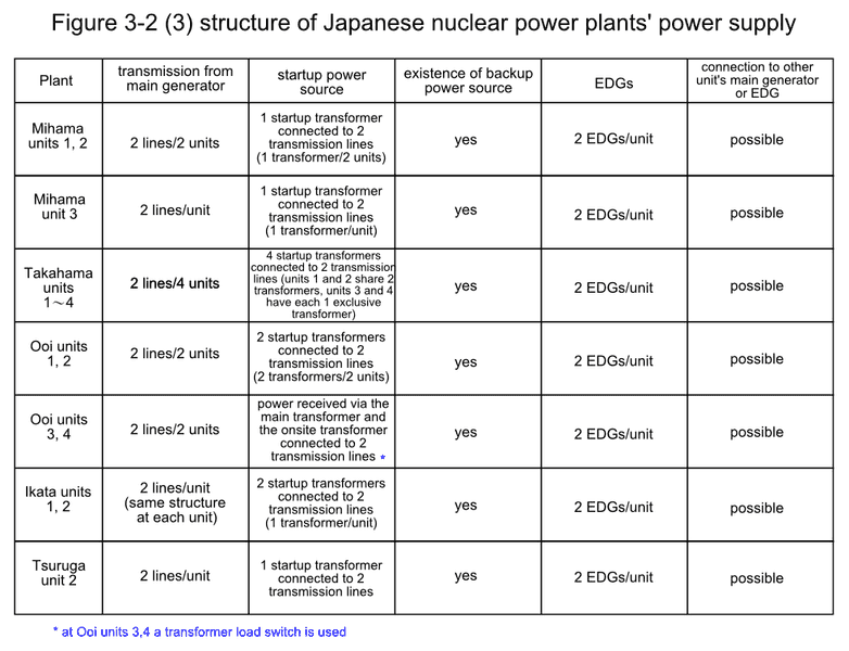

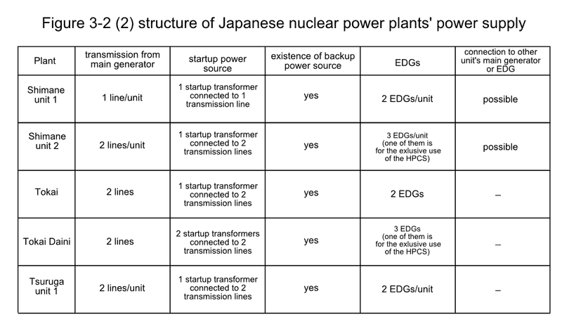

The structure of Japanese nuclear power plants' power supply is shown on figures 3-2 (1) to 3-2 (4) [http://www.nsc.go.jp/info/20110713_dis.pdf 75/96-78/96].
Figure 3-2 (1)
Figure 3-2 (2)
Figure 3-2 (3)
  • #407
Figure 3-2 (4)
Figures 3-3 (1) and 3-3 (2) are examples of electric power structure concept diagrams [http://www.nsc.go.jp/info/20110713_dis.pdf 79/96-80/96]. The seismic resistance classes of emergency onsite power supply equipments in Japanese nuclear power plants are indicated in figure 3-3' (1) and 3-3' (2) [http://www.nsc.go.jp/info/20110713_dis.pdf 81/96-82/96].
(2) Present status of design and plant resistance capacity against SBOs

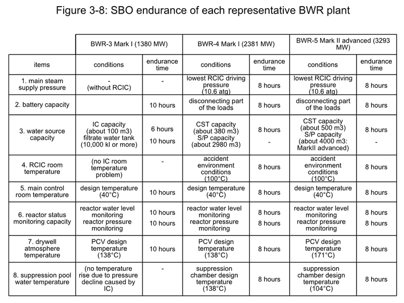

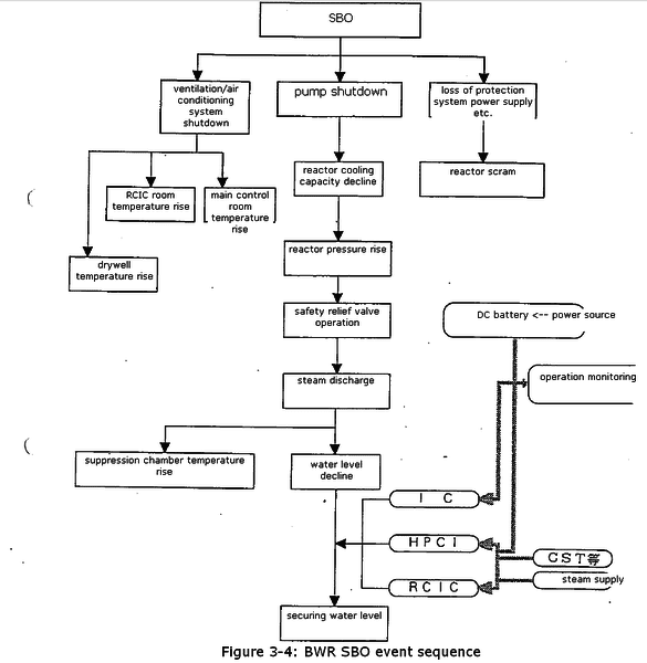

(2) Present status of design and plant resistance capacity against SBOs [http://www.nsc.go.jp/info/20110713_dis.pdf 16/96].
① BWRs

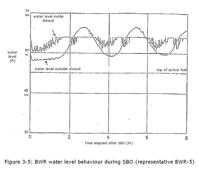

In the case where a SBO occurs, the reactor automatically scrams for a reason such as the loss of electric power at the reactor protection systems. After scram, because of reactor decay heat, reactor pressure rises and as a result, as the reactor steam is evacuated from the S/R valve (safety relief valve) into the suppression pool, the reactor water level temporarily decreases. In order to secure core cooling, it is necessary to maintain reactor water level. As core cooling functions not depending on AC power, one can use IC (isolation condenser system) and HPCI (high pressure water injection system) on BWR-3, RCIC (reactor isolation cooling system) and HPCI (hereafter referred to as "RCIC etc.") on BWR-4, or RCIC on BWR-5, so in order to mitigate or recover from reactor water level decline, it is necessary to activate at least the IC or the RCIC.
The continuous operation of the IC or RCIC is restricted by the "main steam supply pressure" which supplies the RCIC etc.'s driving steam, by the "battery capacity" which is the DC power source for controls, and by the "water source capacity", which supplies the water injected into the core. The duration during which the IC can maintain cooling is determined by the IC's condensing ability, that is to say, the isolation condenser's capacity, so that the main steam supply pressure is not a restriction. Furthermore, as the ventilation and air conditioning systems are shut down due to the loss of AC power, the "RCIC room temperature", "HPCI room temperature" and "main control room temperature" may become a restriction to the continuous operation.
After the reactor water level is secured, as the reactor steam due to the core decay heat is discharged into the suppression pool by repeatedly opening and closing the S/R valve, the suppression pool's temperature rises. As it is feared that radioactive substances are released during reactor steam discharge, in order not to release those into the environment, the soundness of the containment is necessary. For that reason, the rising of the "suppression pool temperature" which rises when reactor steam is discharged, and of the "drywell atmosphere temperature" which rises as the drywell cooling system shuts down due to the loss of AC power, become restrictions. The sequence of events during a BWR SBO is shown on figure 3-4 [http://www.nsc.go.jp/info/20110713_dis.pdf 83/96].
We evaluated the resistance capacity against these causal factors in plants representative of each reactor type.
i) Maintaining core cooling
a) Main steam supply pressure
In BWR-4/5 plants, reactor water level temporarily declines, but recovers due to the activation of the RCIC etc., and as the core is kept covered, as long as the RCIC etc. is operating, the water level is maintained (figure 3-5 [http://www.nsc.go.jp/info/20110713_dis.pdf 84/96]). On the other hand, as the reactor pressure is maintained at the pressure adjusted by the safety relief valve, it is estimated that the steam supply to the RCIC turbine (and to the HPCI turbine) can be sufficiently maintained during SBO. However, as mentioned above, as BWR-3 plants are equipped with an IC, main steam supply pressure is not a restriction factor for BWR-3 plants. Figure 3-6 shows an IC system outline diagram, and figure 3-7 a RCIC and HPCI system outline diagram [http://www.nsc.go.jp/info/20110713_dis.pdf 85/96].
b) Battery capacity
In BWR-3 plants, as the unncessary loads such as the uninterruptible AC power systems are shut down or disconnected within the first hour, battery capacity is such that IC operation and reactor status monitoring can be sustained for about 10 hours.
In BWR-4/5 plants, as the unncessary loads such as the uninterruptible AC power systems are shut down or disconnected within the first hour (see 3.4. (4) below), RCIC etc. operation and reactor status monitoring can be sustained for about 8 hours (in BWR-4 plants, each of the RCIC and HPCI can be operated for 4 hours). However, in some of the plants it is necessary to temporarily put the uninterruptible AC power systems in service (albeit with unnecessary loads being disconnected) in order to perform reactor status monitoring (water level, pressure).
However, in BWR-4/5 plants, in the case where unnecessary loads are not disconnected, the duration during which power can be supplied is, to put it briefly, about 2 to 4 hours.
c) Water source capacity
In BWR-3 plants, the IC can provide cooling for 6 hours with the isolation condenser as water source, but as it can be replenished via the fire extinguishing line from the filtrate water tank, its cooling capacity can be prolonged for 10 more hours.
In BWR-4/5 plants, as it can be supplemented using the CST (condensate storage tank) as water source, the RCIC etc. has a feed water capacity of about 8 hours. This is calculated using the CST's minimum capacity, and generally in normal operation a larger capacity is available.
d) RCIC room temperature (or HPCI room temperature)
In BWR 4-5 plants, an analysis with a model considering the heat released by the pump and the pipes and the walls' and floors' calorific capacity, resulted in a soft rise of the RCIC (or HPCI) room temperature after the shut down of the ventilation and air conditioning system, and the environment temperature of 100°C used in hardware design is reached after 8 hours.
However, in BWR-3 plants, as they are equipped with an IC, room temperature rise is not a restriction factor.
e) Central control room temperature
In BWR-3/4/5 plants, an analysis with a model considering the vital power source, the DC power supply, etc, as thermal loads, and the panels' main bodies', the walls' and the floors' calorific capacity resulted in a soft rise of the central control room temperature after the shut down of the ventilation and air conditioning system, and the environmental condition maximum temperature of control panels of 40 °C is reached after 8 hours (however it is reached after 10 hours in BWR-3 plants).
ii) Maintaining containment soundness
a) Drywell atmosphere temperature
An analysis with a model considering the heat from the reactor pressure vessel, the heat released by the drywell walls, the heat absorbed by construction materials and frame resulted in the drywell atmosphere temperature remaining lower than design temperature after an 8 hour long SBO.
b) Suppression pool temperature
It takes 8 hours or more for the suppression chamber's design temperature (Mark-I: 138°C, Mark-II: 104°C) to be reached by the suppression pool water temperature.
However, in BWR-3 plants, as the IC is operated, the reactor pressure declines, and there is no causal factor for the suppression pool temperature to rise. While the design temperature of the IC shell, which is the IC's water source, is 121°C, the water in the IC shell takes the heat from the steam in the tubes and boils, then the evaporated steam is released into the atmosphere via the vent pipe, so as long as water is present, the design temperature is not exceeded. The IC has sufficient water source capacity to operate for about 10 hours.
The evaluation results of representative BWR plants are shown on figure 3-8 [http://www.nsc.go.jp/info/20110713_dis.pdf 86/96].

② Loss of offsite power precedents [http://www.nsc.go.jp/info/20110713_dis.pdf 20/96]
As a result of a survey of loss of onsite power in Japanese nuclear power plants, from start of operation to March 1988, we found one PWR case and 3 BWR cases of precedents corresponding to the above "loss of offsite power" definition. (However, one of the BWR cases occurred due to a design characteristic of the plant, and it is thought that similar events can no longer occur in the future due to design changes.) See Figure 3-13 [http://www.nsc.go.jp/info/20110713_dis.pdf 91/96].
All these loss of offsite power precedents were caused by a loss of power grid due to typhoon or snow, but power supply by EDG was successful. Furthermore, offsite power was restored within 30 minutes.
Also, in addition to this, we found 3 PWR cases and 3 gas cooled reactor cases of precedents where EDGs were started and connected to the loads after partial loss of external power. In those 6 cases, the backup power source was available (operationally, priority is given to starting EDGs), so that the above mentioned "loss of offsite power" definition does not apply.
③ Offsite power restoration
On the basis of the above mentioned loss of offsite power precedents, offsite power is restored within 30 minutes, and compared with the power restoration precedents in foreign countries reported in 2.3.(1), it can be thought that our country's nuclear power plants' offsite power restoration capacity is extremely good.
However, considering that the small number of data covering nuclear power plant "loss of offsite power", instead of limiting our scope to the precedents in nuclear power plants, we shall infer the offsite power restoration capacity in nuclear power plants from a broad evaluation of the restoration of two-line power transmission lines in Japan.
In order to infer nuclear power plant offsite power restoration capacity from two-line transmission line accident data, we considered the following:
a) "loss of offsite power" can be categorized by causes, whether an onsite cause or an external network cause, or severe weather causes. External transmission network causes are due to concrete transmission line accidents and also severe weather causes consist in onsite troubles or transmission line accidents caused by snow or typhoon severe weathers. For that reason, it can be said that the restoration capacity of external power network caused or severe weather caused "loss of offsite power" is intimately related to the restoration capacity of two-line power transmission line accidents.
b) Concerning prolonged loss precedents resulting of two-line power transmission line accidents, we surveyed the accident situation, and we left out of the present evaluation the cases where supply to the concerned area was not hindered. This is because in cases where hindrance of supply does not occur, there is little necessity to promptly perform restoration work, and also there are cases where restoration is in fact not performed, and taking those into account would not contribute to a suitable evaluation.
c) The probability of two-line power transmission line accidents presents a decline trend from start of operation to 1961, and it can be thought that the data themselves show a change (reliability upward trend) of two-line transmission line reliability between the years up to 1961, and the recent years after 1961.
For that reason, and also considering the year of start of operation of nuclear power plants in Japan, it is thought that using the data of 1962 and later is the most suitable for an evaluation of restoration capacity.
Based on the above prerequisites, the result of the evaluation inferring offsite power restoration capacity of nuclear power plants is as follows:
(a) The number of accidents of two-line power transmission lines (cumulative number in the evaluation period) and the calculated restoration failure probabilities are shown in figures 3-14 (1) and 3-14 (2) [http://www.nsc.go.jp/info/20110713_dis.pdf 92/96]. According to these figures, the probability of restoration failure of 30 minutes or above is about 0.05, and most accidents are restored within 30 minutes.
(b) When we evaluate restoration capacity over an even longer period, the two-line transmission line accident data present dispersion, and we evaluated the restoration capacity with a Weibull fitting. Considering the year of start of operation of nuclear power plants in Japan, removing the cases of prolonged external power losses without hindrance of supply, and using the two-line transmission line accident data in 1962 and later, an extremely good restoration capacity is obtained, for example with a probability of restoration failure of about 0.001 for an 8 hour duration. One must note also, as reference data, that removing the cases of prolonged external power losses without hindrance of supply, and even using all the two-line transmission line accident data since transmission line operation start, the restoration failure probability for an 8 hour duration is about 0.03.
Concerning the external power restoration capacity in Japanese nuclear power plants, as explained above, in all real cases of loss of offsite power, power was restored within 30 minutes, and even in the results of the evaluation based on two-line transmission line accident data, it is sufficiently good compared with the American loss of offsite power precedents presented in chapter 2.
