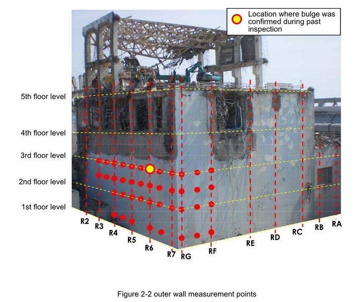

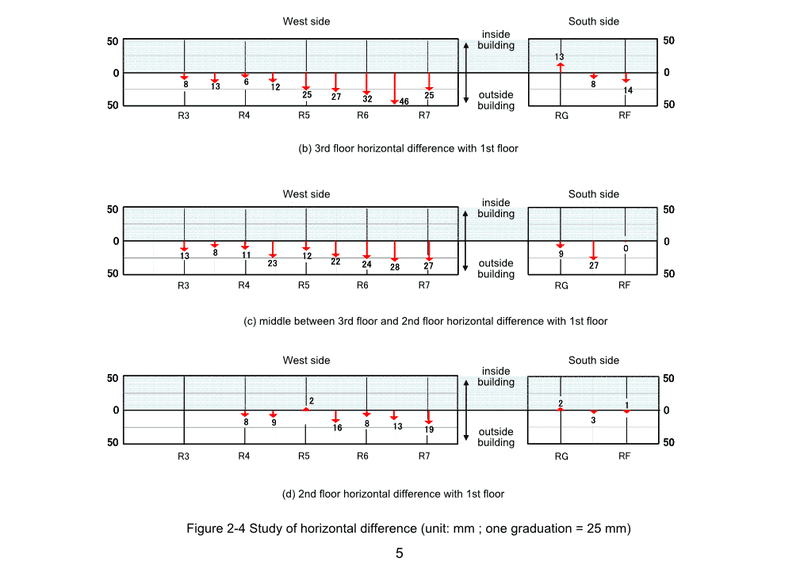

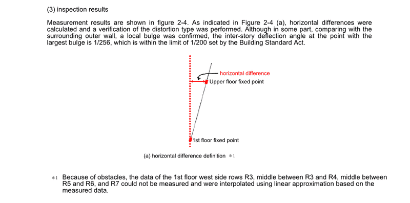

http://www3.nhk.or.jp/news/genpatsu-...626/index.html Tepco made additional measurements of unit 4's reactor building walls' tilt. Last month a tilt thought to have been caused by the bulge created by the hydrogen expolsion was found at the western wall with a measurement of a 3.3 cm tilt for 13 m of height, which was about half the limit set by the Building Standards Act. Now they found 4.6 cm for 13 m of height on the third floor on the western side. All tilts are within the limits of the Building Standards Act. Tokyo Electric says the pool is supported by other pillars, etc. that are different from the outer walls where tilting was found, and that as a result of seismic analysis, there is no seismic safety problem.
http://photo.tepco.co.jp/date/2012/2...20625_02j.html pictures of the unit 4 wall measurements (Japanese version)
http://www.tepco.co.jp/cc/press/2012/1205832_1834.html press release about the new unit 4 wall measurements (Japanese version)
http://www.tepco.co.jp/cc/press/betu...20625j0201.pdf press release attachment (Japanese version) (with diagrams, etc...) "Report dealing on a study about seismic safety taking into consideration local outer wall bulging at Fukushima Daiichi unit 4 reactor building"

Quote by tsutsuji View Post
Any words on measuring error? Or was there actual change between one measurement and the next?

Quote by zapperzero View Post
They are not measuring the same measurement points. The new measurement with the 46 mm horizontal difference is located on the 3rd floor, halfway between the rows R6 and R7, while the older measurement of "approx. 33 mm" for "West 2" in http://www.tepco.co.jp/en/nu/fukushi...20525_05-e.pdf 6/17, was located on the same floor but exactly on row R6.
There might be a small change of 1 mm between both measurements on west2/R6-3rd floor as the report now says 32 mm (instead of "approx. 33 mm").
I attach translations of the bottom of page 7/57 and of page 9/57 of http://www.tepco.co.jp/cc/press/betu...20625j0201.pdf
page 7/57
page 9/57
