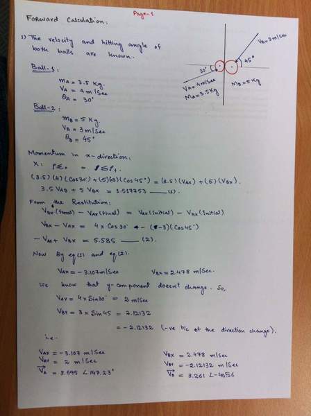

The velocity of body-2 before hitting was 3m/sec and angle was 45 degree.
The velocity of body-2 after hitting is 3.26197 m/sec and the angle is -40.565 degree.
I have to calculate the hitting velocity and angle of the Body-1.
By the conversation of momentum in the x-direction I have calculated the x-component of the body-1 before and after the hitting.
I am unable to calculate the y-component of the Body-1 before and after the collision.
I have get one equation that :
V_body1_y_component (before collision) = V_body1_y_component (after collision)
But I am not getting numerical value for the y-component of the body-1.

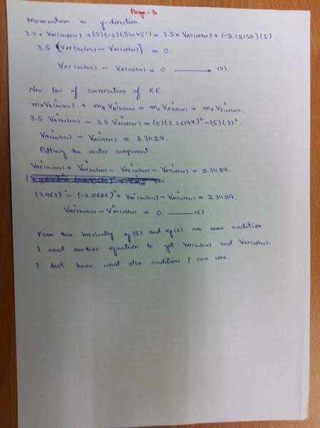

You cannot conserve momentum for only mass 1, as it experiences an impulsive force due to collision with mass 2. So, consider the initial and final y-momentum of mass 2 in this equation too.

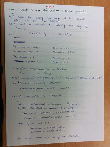

Lets look at what you can say right off the bat. First, the collision is elastic, and there are no external forces, so kinetic energy is conserved, and momentum is conserved. One is a scalar, the other, a vector. Let's write these equations down.
[tex] p^i _1 +p^i _2 = p'^i _1 + p'^i _2[/tex]
[tex] T_1 +T_2 =T'_1 +T'_2[/tex]
with primed variables as after and un-primed as before. The [itex]i=1,2[/itex] for the two components of the vectors in the x=1, and y=2 directions, and the subscripts 1 and 2 denote the different bodies. All in all you actually have three equations:
[tex] p^x _1 +p^x _2=p'^x _1 +p'^x _2[/tex]
[tex] p^y _1 + p^y _2 = p'^y _1 +p'^y _2[/tex]
[tex] m_1 v_1 ^2 +m_2 v_2 ^2 = m_1 v'_1 ^2 + m_2 v'_2 ^2[/tex]
This should help to get you back on track.

My calculations are in the attachment.
First I solve the problem in forward direction and then I try to solve it in the reverse direction to get the same result.
I have used all the conditions for conversation of momentum (x and y-direction) and the conversation of KE.
But I still required another equation.
Please help me to solve this problem.
I will be very thankful to you.
