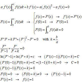

Hi !
There are two obvious solutions f(x)=0 and f(x)=1.
In order to show that there are no other solution, let :
[itex]F(x)=\int_0^x f(x)dx[/itex]
Then, bring back F(x), f(x)=F'(x) and f'(x)=F''(x) into the ODE
This leads to a second order ODE, rather easy to solve, thanks to the conditions F'(0)=f(0)=1 and F(0)=0.

Jun27-12, 12:34 AM   #5
So, I suppose that you did it.
Jun27-12, 03:04 AM   #6
Thanks to all for your suggestions.
@JJacquelin: your derivation is very helpful.
The remaining equation without the boundary conditions:
[itex]
(F'(x)-1)(F(x)+k)=C
[/itex]
should be also solvable for more complex situations. Mathematica delivers a general solution in terms of the Lambert W (product log) function.
Anyway, this is something I can work with.
Thanks again,
Maarten
