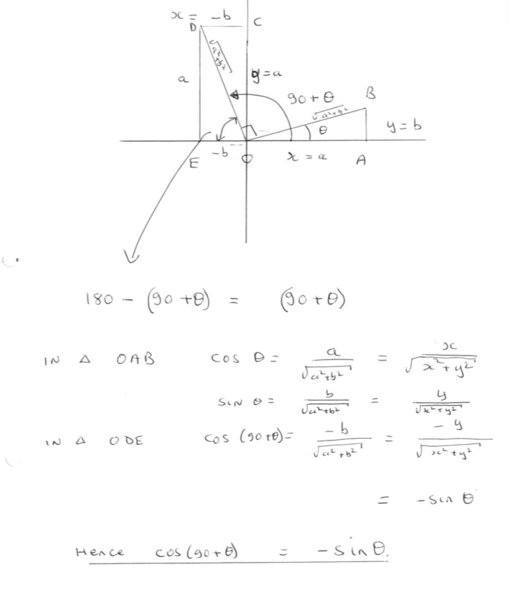

hey Studiot , thank you for your reply , it solved most of my difficulties but i still have a confusion
in first quadrant , we get cos theta = x/underoot x^2 + y^2
but then if we do it for 90+theta .. my value for sin (90 + theta) is -x/underoot x^2 + y^2
which is basically our previous value of cos theta * (-)therefore sin 90 + theta should be equal to - cos theta , not cos theta
Yes, that is true. "[itex]cos(\theta)[/itex]" is the x-component of the [itex](cos(\theta), sin(\theta))[/itex] and so is negative as we move from first quadrant to second quadrant.
However [itex]sin(\theta)[/itex] is the y component and does NOT change sign. That is, if [itex]0<\theta< 90[/itex], in the first quadrant, [itex]\theta+ 90[/itex] is in the second quadrant. [itex]sin(\theta+ 90)[/itex] is still positive as is [itex]cos(\theta)[/itex].
Hello again Sam.
Supplementary angles add to 180
Complementary angles add to 90
Complementary angles are more tricky since you have to exchange x and y or sin and cos in the formulae to get the correct triangle.
Sin is still OHMS and cos is still AHMS however.
You do not do this with supplementary angles.
To see why look at the attachment.
The first quadrant triangle with angle theta is shown as OAB.
I have generated a line OD in the second quadrant by adding 90 to theta.
However the triangle you want is not ODC.
The triangle you want is ODE as shown.
Using this triangle the attachment shows that
cos(90 + θ) = -sin(θ)
You should always use supplementary angles where possible for this reason.
go well

ty studiot , i understod itt now , btw if u don't mind me asking , how was my logic wrong ? the one which proved sin 90+theta = - cos theta
You used the wrong triangle. That's why I said complementary angles are more tricky.
It's in the last attachment x/√(x2+y2) is for triangle ODC

Sam I owe you an apology, there was an error in my post7, so well spotted.
I tried this morning but couldn't amend it however I will supply a correction later tonight.
OK I promised an ammendment.
You notices that I had written sin(90+θ) instead of sin(90-θ).
In fact it makes no difference they are the same.
However since this was an unintentional slip and I should have used sin(90-θ) here is a geometric proof that
cos(90+θ) = -sin(θ)
in attachment 1.
Since is is some effort I will leave you to construct similar proofs for sin and tan.
It is really much easier to use Millenial's method for this and I have shown all three in attachment 2
