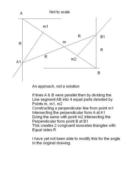

  • One participant describes the problem of constructing two circles tangent to two non-parallel lines, specifying conditions for tangency and the requirement that the circles pass through given points on each line.
  • Another participant identifies two situations based on the relationship between the line connecting the two points and the angle bisector of the lines, noting that one situation is straightforward while the other requires further exploration.
  • A participant introduces geometric relationships involving perpendicular segments from the lines to the centers of the circles and discusses the dependency of the radius on the distance between the two points.
  • Sketches are shared to illustrate concepts such as common tangents and the relationships between the circles and the lines, with some participants questioning the implications of these sketches on the problem.
  • One participant shares observations from experimenting with different circle configurations, noting a line that passes through specific points and suggesting a relationship between angles formed by the lines and the circles.

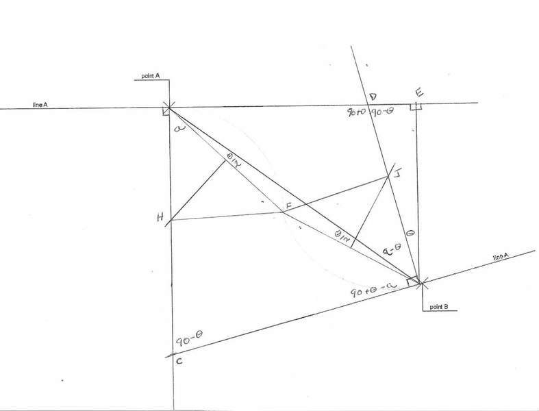

  • A later post introduces a trigonometric approach to the problem, indicating a shift in method while cautioning that this is a different drawing from previous sketches.
