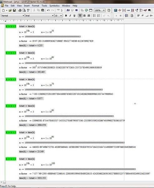

An alternative produce to consider is Mathcad (it handles arbitrary precision arithmetic and has a Matlab interface and its programming is similar enough to Matlab to allow porting of many programs without too much effort). I've attached an image of part of a simple worksheet that factorizes the decades of ten (plus a small constant) and shows the times for each factorization ... some of them are quite lengthy.
Another package to consider is the non-commercial SMath, a Mathcad-like application that also does arbitrary precision arithmetic. I'm not sure whether it has a factor function.
