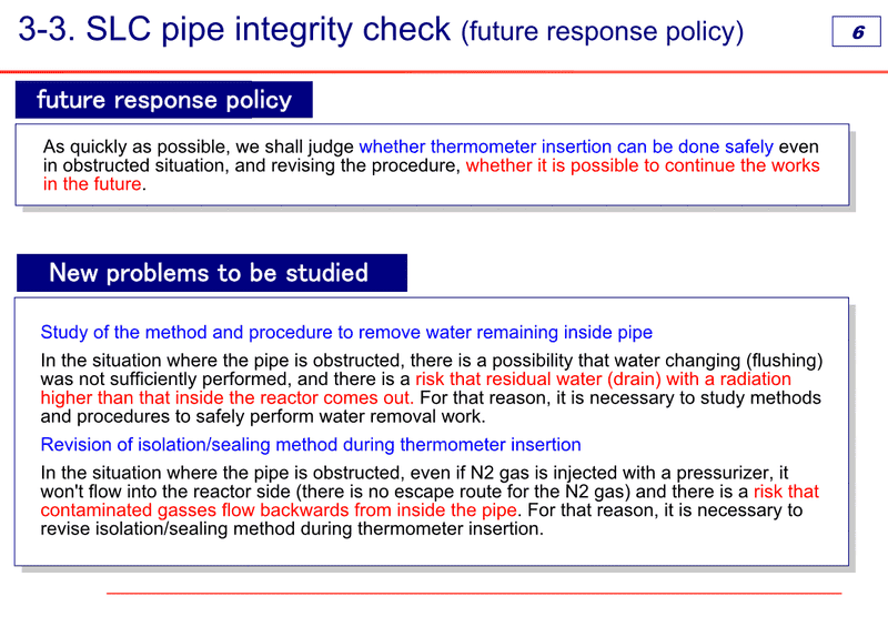

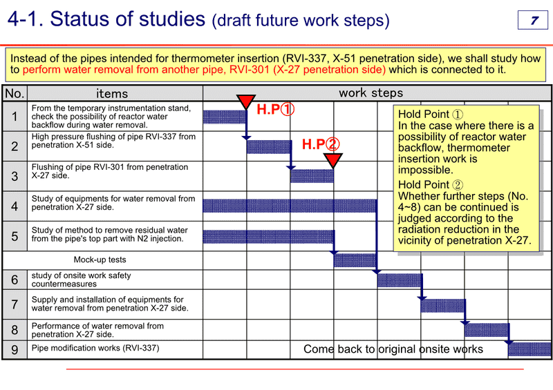

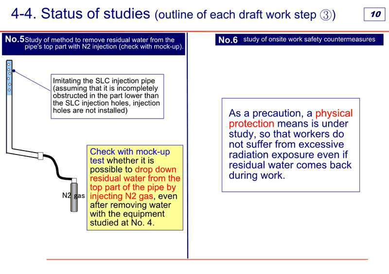

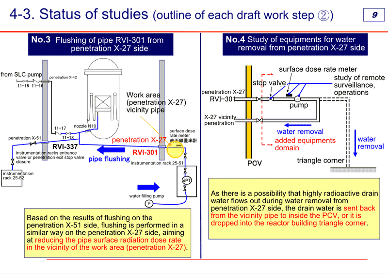

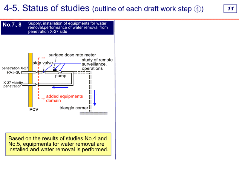

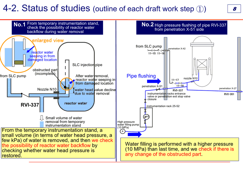

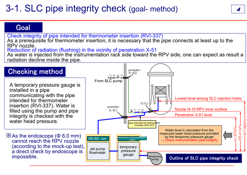

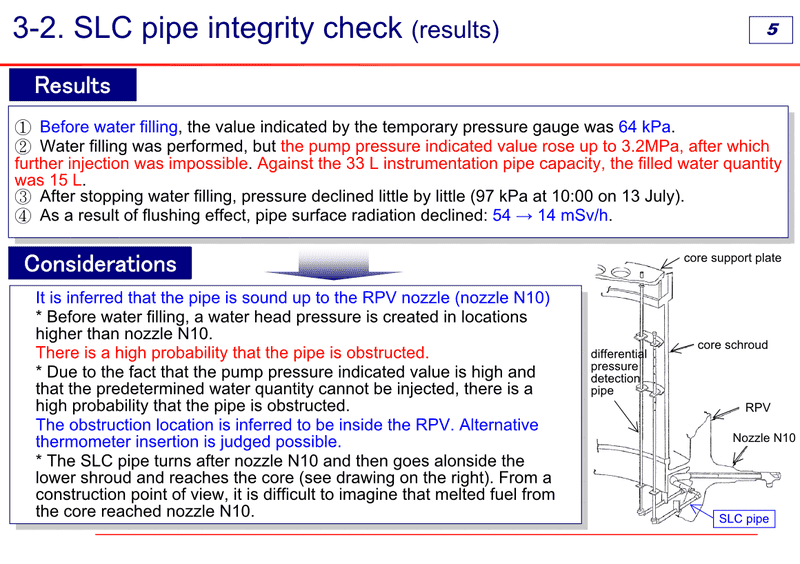

tsutsuji said:
That's right. It was a mistranslation.
計装配管の健全性を確認 should have been translated as "checking instrumentation pipe soundess" or "we shall check instrumentation pipe soundness".
There is a second handout on the same topic dated July 13: www.tepco.co.jp/en/nu/fukushima-np/images/handouts_120713_04-e.pdf
Hmm, could the pipe simply have molten and welded shut?

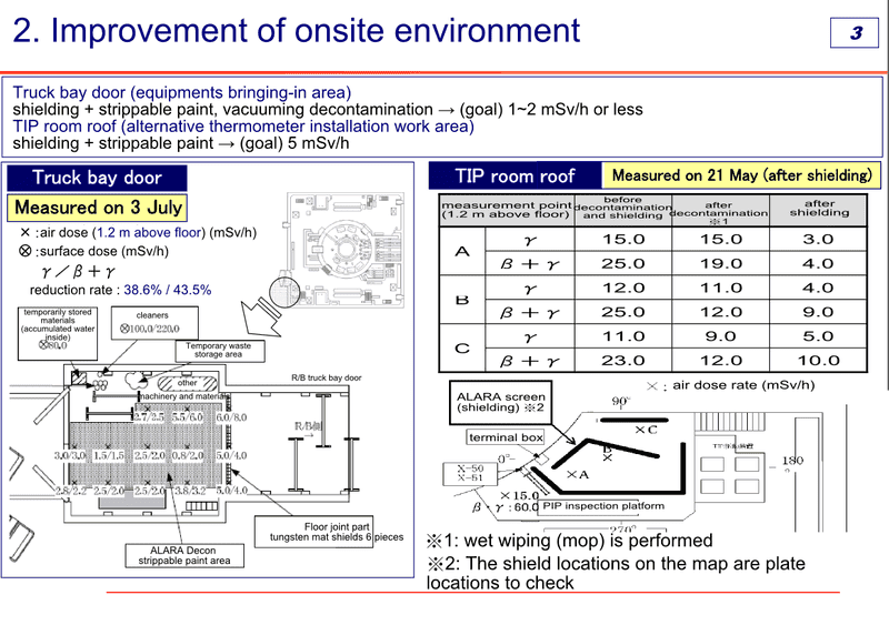

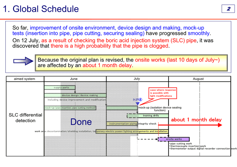

tsutsuji said:
The 8th mid & long term meeting was held on 30 July 2012:
3-1 Cooling by closed loop water injection
http://www.meti.go.jp/earthquake/nuclear/pdf/120730/120730_01g.pdf Unit 2 alternative thermometer installation progress status
1) Previous related topics:
1 March 2012 report ( https://www.physicsforums.com/showpost.php?p=3795578&postcount=12465 part 1, https://www.physicsforums.com/showpost.php?p=3796935&postcount=12485 part 2, https://www.physicsforums.com/showpost.php?p=3799356&postcount=12492 part 3)
23 April 2012 report: https://www.physicsforums.com/showthread.php?p=3939578#post3939578 (insertion and freezing mock-ups)
28 May 2012 government-Tokyo Electric mid and long term response committee, steering committee (6th meeting): https://www.physicsforums.com/showt...ighlight=alternative+thermometers#post3941037 Results of the surveys on location concerning the environment improvement for the purpose of installing alternative thermometers in unit 2's RPV
01 June 2012 videos:
http://photo.tepco.co.jp/en/date/2012/201206-e/120601_02e.html "Decontamination around the truck bay door at Unit 2, Fukushima Daiichi NPS" (released on 1 June 2012)
http://photo.tepco.co.jp/en/date/2012/201206-e/120601_01e.html "Mock-up test to check the insertability of the alternative thermometer at Unit 2" (released on 1 June 2012)
25 June 2012 Mid & long term meeting : Unit 2 alternative thermometer installation progress status: https://www.physicsforums.com/showpost.php?p=3984965&postcount=13523
12 July 2012: Checking SLC pipe integrity handout 1: http://www.tepco.co.jp/en/nu/fukushima-np/images/handouts_120712_05-e.pdf
13 July 2012: Checking SLC pipe integrity handout 2: http://www.tepco.co.jp/en/nu/fukushima-np/images/handouts_120713_04-e.pdf
2) Translation:
01/11
02/11
03/11

Translation:
04/11
05/11
06/11

Translation:
07/11
08/11
09/11

tsutsuji said:
Translation:
04/11
05/11
06/11
"The obstruction is inferred to be inside the RPV."
This is very interesting.
Let's remember how RPVsapparently fail.
Look at this (the sources are reputable, I hope) which I found here.
Let's say it in a very prosaic manner: they seem to p!ss, instead of sh!tting.
I mean, look at Swedish experiment still photo. Hottest and softest area first gets penetrated. It flows, it doesn't drop.
What if corium sploshing out of vessel warmed up pipe, making a (near) perfect weld in combination with containment overpressure?
(NUCENG, any idea?)
(BTW, tsutsuji, thank you again very much for translating this mega-interesting piece of information!)

Those failures tests are on vessels with considerably less mass and wall thickness and a bone dry simulated RPV. It also doesn't have the myriad of protrusions that the normal RPV has. I'm not sure you can draw much from that test when looking at fukushima.
