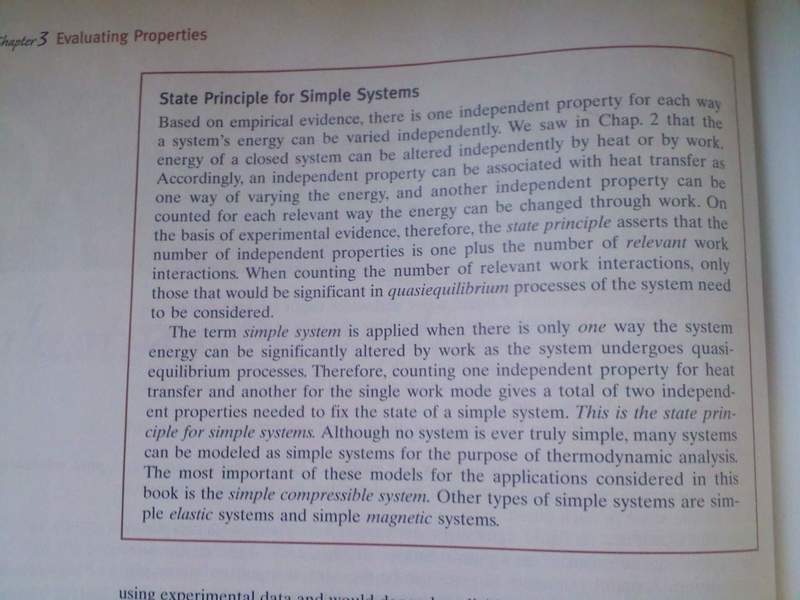

In the meantime, I was reviewing Moran and Shapiro's fundamental of thermodynamics, and had a question about the state principle for simple systems. I attached the segment of the book that talked about it.
I was just confused about their explanation of the state principle. To me it seems to say that if I have a rigid tank and I start heating the system from state 1 to state 2, only one state property is required to define all other state properties as no work is being done. However, I am confused as if for example the container has ideal gas, the ideal gas equation still dictates that two state variables be known to find another regardless of the system?
Also, does this principle apply to specific internal energy and enthalpy of gases given that if a gas is calorically or thermally perfect h and u are functions of temperature only, and also in Anderson's Modern Compressible Flow, these two properties are said to depend on chemical reactions and intermolecular forces, with no mention of the state principle? Does h and u depend on more than two variables for a non-simple system and what if the gas is thermally or calorically perfect?
This is correct - if the container is rigid.
This is also correct - but recall that, in this case, the container is rigid. This means that the volume cannot change.
Note that the state principle described is for simple systems ... you are describing complicated systems so what do you think the answer is?
Also - consider the stress on "independence" in the description of the state principle.

A better description of equilibrium is the idea of what happen to an infinitesimal displacement from equilibrium.
Yes it is.
In fact this allows for the idea to be extended easily to a dynamical equilibrium.
(Note: your examples are also in the lecture I linked to earlier.)
The book is using poor pedagogy.
Just reading through the few bits shown to us here you can feel your brains congeal.
We must be able to point OP at an introductory lecture course or something better than that book.

With regards to my question about specific internal energy and enthalpy, I'm still confused about whether the state principle dictates that they must be functions of 2 state variables and why they are only functions of one for certain idealizations?
In the example you gave, there are only two parameters that vary - count them - ergo, knowing one, and the relationship between them, you know everything.
Lastly, the insulated rigid tank mentioned in my earlier post, although volume is constant, can the specific volume change? For instance, if I add in more gas to this tank or have another identical tank with more gas in mass , would these constitute the same system or be considered different systems?
The simple model you are being treated to at this early stage only admits the three variables - and only works for specific types of systems - there are other models that would apply to the other examples. Try not to get ahead of yourself. No - that's not right - rather: try to be aware as you read that you are not being supplied with everything in one go: the authors are providing stepping-stones to more complicated methods.
You do risk overreaching yourself by trying for more complex models before you understand the core concepts. Make sure you can do the problems in the chapters you have read.
