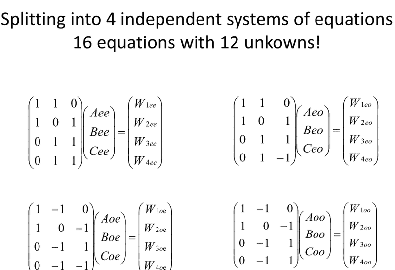

Dear fellows,
during my internship I've stumbled over a problem of analysis. To cut things short some pseudoinverses have to be calculated. For one of them it does not work, s.t. A'*A [itex]\neq[/itex] I.
I just wondered about the requirements to find a pseudoinverse. One of the eigenvalues is zero, but as far as I understand that eigenvalues different than zero are not a requirement.
The matrix under consideration is that one:
A = [1 -1 0; 1 0 -1; 0 -1 1; 0 -1 1];
If anyone could help me that would be really great :).
Cheers and thank you very much in advance,
spookyfw

Hey spookyfw and welcome to the forums.
I just took a look at the Moore-Penrose pseudo-inverse from a grad linear algebra book and for that pseudo-inverse, the relation ship is that BAB = A and ABA = B.
Are you using this one or some other one?
Aug17-12, 06:49 AM   #3
Hi chiro,
thank you very much for your reply. Yes I am using the Moore-Penrose pseudo-inverse. Actually the original problem can be seen in the attached picture. After using the pseudo-inverses it is stated that only the first three systems have a solution, but that there is too little information to solve for A00, B00 and C00. When I am multiplying with the pseudo-inverses I get the unitary matrix on the left hand side, but for the last system. So I wondered how that is related to the last one not having a solution and what the reasoning is. I thought about independence, but there is also row-degeneracy in the matrix of the first system.
I hope that this still makes sense. Any idea?
spookyfw

Aug22-12, 01:24 AM   #7
Thank you very much. I think I spotted the problem with the matrix, as for square-matrices the Moore-Penrose inverse needs independent vectors, but unfortunately there is two dependent column vectors. At first sight I just spotted degenerate row vectors, but of course there has to be dependent ones with a 4x3.
