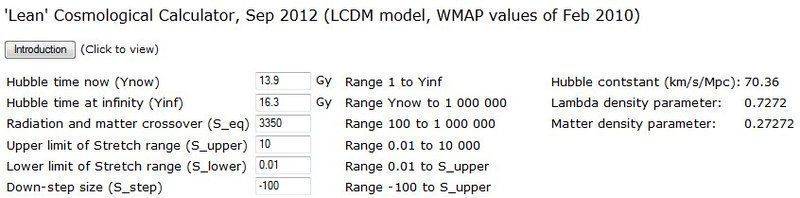

The 'single-step problem' has been solved in CosmoLean_A17 and the 'few issues' with the flexible rounding of column data are gone as well, or so I hope. Please try it out and report any anomalies.
The most important differences are:
  1. The info-popups have been mostly reworded and include comments as received in PMs.
  2. The stretch range inputs arranged to be more consistent with the output table, from highest to lowest stretch.
  3. Some 'logic' built into the input processor so that 'one-shot' outputs are intuitively achieved by either making s_step zero, which gives output for s_upper only; or by making s_upper and s_lower equal to each other, irrespective of s_step.
  4. The number of decimals (rounding) of column data are adjustable individually. Becomes active on clicking Calculate and will remain so until changed again, reset clicked, or the page is refreshed.
  5. Overall accuracy has been improved by resolving some coding issues. It now seems to work accurately up to s =10 000.
  6. Some input validation and protection against crash of program are included. More to be considered.
  7. On the drawing board: "into the future" (s < 1).

The new version is a pleasure to use.
We should accumulate a bit of "user manual" type information like that in your post#21, three or four posts back.
Putting step=0 makes it very simple to use as a one-shot.
It's mostly self-explanatory how to use it, so not very much by way of "user manual" seems necessary. but at least the hint about setting step to zero.
The feature of deciding on how many decimal places to show is quite nice. It rounds off for you. I like seeing 3-place precision but knowing I'm riding on 6-place (like a new set of tires on the car, you just feel better.)
Visually clean, sufficient but just what's essential.

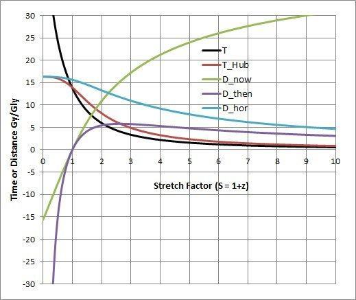

BTW, work-shopping the 'back to the future' options on a spreadsheet, it struck me that things like D_now and D_then are then ill defined. For the past is is easy; we think in terms of a source observed at (say) stretch 2 and we ask the questions: how far was it at time of emission and how far is it now?
The equivalents for the future are more obscure. Since we cannot observe anything from the future, we may have to think in terms of emitting some signal now and answer the question: How far must an observer be from us to receive that signal at a stretch of (say) 2, both now and then?
Or is there a better way?
PS: Lean gives for s=2, D_now=11.1 Gly and D_then half of this. For a future s=1/2, I get via spreadsheet: D_now=7.4 and D_then twice this.

I think the present Lean format is perfect WITHOUT a future extension because it communicates easily and directly. Beginners can get the concepts without trouble.
I would not try to add on to the existing Lean A17 version. It might diminish its value as a beginner's cosmology tool.
But the future is really interesting and a new format like "Lean+" with future would be new in cosmology calculators AFAIK. I will to help think it out and perhaps you can bounce things off me and use my reactions.
The way I think about it, there are two ways it could be. One way is about what galaxies could we send a signal to in future? How far away is target galaxy now? How far away will it be when the signal gets there---say, in S=1/2, when distances are twice what they are today?
So the Distance labels are more general they are Demit and Dreceive.
Or maybe call it Dsend and Dreceive.
If it is the PAST segment of the table then these are just the same as Dthen and Dnow. The distance from us back then when it sent us the light and the distance now on the day we get it.
But in the FUTURE segment of the table Dsend is the distance from us to the target on the day we send the signal
and Dreceive is the distance from us to the target on the day they get the signal.
Dsend (the distance of the target today when we send the signal) cannot be more than around 16 billion ly (proper) or it will never get there. That's what event horizon means.
However Dreceive (the proper distance of the target when the message finally gets there) can be very very far.
I don't know the present event horizon---somewhere around 16 and eventually will converge to 16.3. But whatever it is, say it exactly 16. then the closer the galaxy is to 16 when we send the message the longer it is going to take for the message to reach target, and the farther away target will be when it arrives. I don't think there is any theoretical limit on how big Dreceive can be.
The other way I don't see how to implement and can't tell on short notice whether it's good or not. The other way is what I think LINEWEAVER does in bottom panel of his Figure 1. that is he PUTS THE EARTH INFINITELY FAR IN THE FUTURE and looks back in a somewhat similar way as before
So then every finite S, not only S>1 but also S=1 and S<1 corresponds to some era which is in the past of the earth at this imaginary infinite future. I think now that it would be unwise to attempt at this point because it appears to involve "conformal time" and only comoving distance (not proper) seems well-defined. the infinite future is not a definite time so proper time might break down as a concept. It might be a big headache to try this second way. But it is what Lineweaver seems to do in one of the panels in his figure 1. Sorry about the unprepared response. Need more time to think.

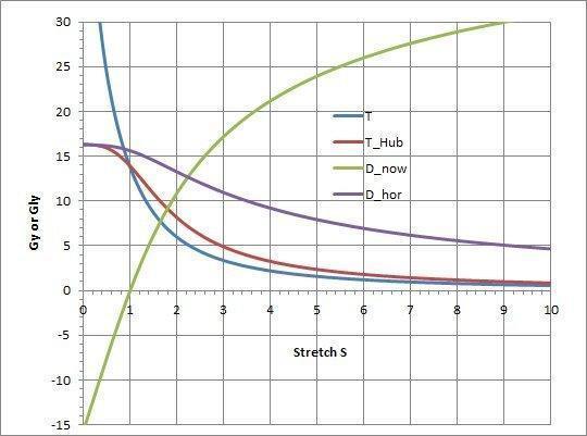

The latest version (as in Marcus's signature) is CosmoLean_A20, which adds an 'Introduction' button with some hints for usage. It is supposed to be fairly stable now and it is perhaps time to give an idea of the underlying formulas and conventions. It follows the development of the 13.9/16.3 simplified model proposed by Marcus, but with inclusion of the early stage radiation energy density.
The basic input parameters are:
present Hubble time [itex]Y_{now}[/itex], long term Hubble radius [itex]Y_{inf}[/itex] and the redshift for radiation/matter equality [itex]z_{eq}[/itex]. Since the factor [itex]z + 1[/itex] occurs so often, an extra parameter [itex]S = z + 1[/itex] is defined. From these, the Friedman equation terms for the cosmological constant, radiation and matter can respectively be found for a perfectly flat LCDM model.
[tex]\Omega_\Lambda = \left(\frac{Y_{now}}{Y_{inf}}\right)^2, \ \ \,
\Omega_r = \frac{1-\Omega_\Lambda}{1+S_{eq}}, \ \ \,
\Omega_m = S_{eq}\Omega_r [/tex]
The 'heart' of any simple cosmological calculator is the time variable Hubble constant [itex]H[/itex], which comes from the Friedman equation as:
[tex]H = H_0 \sqrt{\Omega_\Lambda + \Omega_r S^4 + \Omega_m S^3}[/tex]
For perfect flatness, it can be expressed as
[tex]H = H_0 \sqrt{\Omega_\Lambda + \Omega_m S^3 (1+S/S_{eq})}[/tex]
It can be interpreted in terms of the "13.9/16.3 factors" as follows: [itex]\Omega_\Lambda = 0.7272[/itex] and [itex]\Omega_m (1+S/S_{eq})= 0.2728[/itex], which of course sum to 1 (required for perfect flatness). It also shows at a glance how the influence of the various energy densities changes with S. Since S_eq ~ 3350, radiation dominated when S > 3350 and matter dominated for S < 3350, until such time as [itex]\Omega_m (1+S/S_{eq}) < 0.7272[/itex], when the cosmological constant started to dominate the equation.
From H, the following calculator outputs are readily available:
Hubble time [tex]Y(a) = 1/H [/tex]
Cosmic time [tex]T(S) = \int_{S}^{\infty}{\frac{dS}{S H}}[/tex]
Proper distances to a source at stretch S, "now" and "then" respectively,
[tex]D_{now} = \int_{1}^{S}{\frac{dS}{H}},\ \ \ \ D_{then} = \frac{D_{now}}{S}[/tex]
The integration for T(S) to S_infinity is problematic, but is usually stopped at a suitably high S (effectively close enough to time zero).
In principle, the equations can be used for projecting into the future as well. This has been "secretly" sneaked into version A20. If you want to try it out, enter 1 into S_upper and 0.1 into both S_lower and S_Step. Note the time going to some 50 Gy, T_Hubble to around 16.3 Gy and the distances to negative values.
As Marcus has pointed out before, D_now for this scenario is the present distance to a target that will receive our signals with a wavelength stretch S at future time T(a). D_then means the proper distance of the target when they eventually receive our signal, obviously 1/S times farther.
