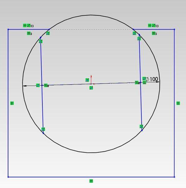

I have an inlet which doubles as an outlet which can vent pressure vessels in about 3-4 seconds which is fine. The ball idea sounds good, I'll sketch something up on Solidworks and put it up later tonight.
Ok I drew up a quick sketch on solidworks. I think this is the idea you were talking about.
Seems a little inefficient with space, essentially all you would need is just a spherical cap that fits over an O-ring. The pressure from the vessel would keep this shut and you can slide it out of the way after depressurization (through another outlet).

I can't quite understand your drawing but that's not important. If I were to have this made, I'd expect to spend a few thousand dollars for the valve, a custom made vessel, engineering and pressure testing. I wouldn't ask for it to be stamped but you could if it's critical. But before anyone can do any engineering on something like this, you need to provide a specification that goes over stuff like what you're putting inside (especially gasses or liquids), what temperature it will be exposed to, what additional ports you need such as for instrumentation or valves, if you need valves or gages that should be defined, if you have a specific material requirement, what dimensions, finishing or painting requirements, cleaning requirements, and a general area you're located into determine local code requirements and suppliers. Can you give any of that?
