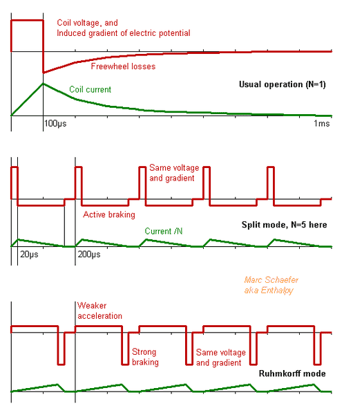

And here's a diagram intended to clarify the changes in the waveforms. Log in if needed, lick to magnify.
I've sketched N=5 for clarity, but real apparatus will probably use a bigger N.
Wave forms are idealized; real-life ones are smoother, and shall be so to protect the components.
I've written Ruhmkorff mode on the last waveforms, by analogy with an ignition coil, but terms like Forward and Flyback mode would sound more familiar to power electronics engineers.

A well designed TMS coil can have 1ms time constant, real ones have a bit less, but forward operation at N=10 or N=100, with fall time shortened accordingly, needs to brake the current actively. The brake circuitry (a lossy freewheel if you wish) is less than obvious, because the brake voltage is (say 10 times) less than the supply voltage, and the brake circuitry shall not misfire during pulse rise, despite users want pulses of both polarities with few ms between inversions.
Referring to the circuit example sketched below (log in if needed, click to magnify):
An IGBT opened long before the pulse decides the polarity. The TMS coil could have been connected between these collectors, but the second transformer insulates the TMS coil and permits a direct gate control. A big E ferrite core suffices for such a transformer, so I feel this combination easier.
The left IGBT defines the rise time of the current pulse, and the supply voltage defines the rise rate.
On this sketch the resistor sets the current fall time in the coil. Operation at big N is meant to reduce losses in the TMS coil, but here most supply power is dissipated in the resistor. While this power is smaller than at N=1, and the resistor easier to cool than the TMS coil, one may prefer to reinject the energy in the supply. A third winding can help this, but since the voltage and current must already challenge the existing main switch technology, this winding shouldn't step up the voltage, so the power dump rail must have a lower voltage than the supply.
An adjustable power dump rail would control the fall time independently, and a braking voltage constant over the pulse may improve the TMS operation by limiting to a uniform plateau the induced electric potential gradient. The rail must accept and transform power but be pre-loaded before the first pulse. Several braking windings of different voltage ratios may help. I preferred to draw a resistor on the sketch
At high N operation, hence with shorter commutation of a smaller current, MOS must be better than IGBT. Soft commutation (resonance) would be nice, except for the clarity of the sketch
Marc Schaefer, aka Enthalpy
