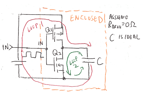

Nov13-12, 12:17 PM
P: 3,883
I am not a power engineer. Please explain from my drawing what is the power drawn from the battery. Assuming capacitor C is ideal and lossless, assuming the on channel resistance of the MOSFET is 0Ω so no ohmic loss.
When IN is low, Q1 turns on, voltage from the battery is connect to the C and charge it up as shown in Loop1. When IN switch to high, Q1 turn off and Q2 turn on, the C is discharged by Q2 through Loop2.
Q1, Q2 and C are inside an isolated enclosed place in the dashed box in . Battery and the IN driver is outside of the box.
1) What is the power input to the box when IN is pulsing to charge and discharge the cap continuously?
2) If there is real power input, how is heat generated inside the box as there is no resistance?
3) If there is no power input, do we expect the battery to last forever in this ideal case?

Nov13-12, 12:43 PM
P: 2,251
Quote Quote by yungman View Post
why not assume it has negative resistance?
the issue is, yung, that when that cap discharges, the energy stored in the cap ends up somewhere. where do you think it goes?
better clip on some heat sinks to the MOSFETs.

a similar question is had when you get some big capacitor (say, 1000 uF and that is good for 50 volts) and you charge it up with a DC supply to, say 40 volts, disconnect the DC supply and then, using a screwdriver, short out the cap. what happens? where did the energy come from? and where did it go?

Quote Quote by rbj View Post
My name is Yungman or Alan
I am using an ideal case, there is no ohmic loss as a start to look at whether there is power involve in an ideal case.
For real case, you can use a MOSFET with very low output impedance to sink or source large current with very little heat. eg, if on channel resistance is 10mΩ, 1A only generate 10mV and power dissipation is very low even if charging a cap to 10V.
In computer, almost all circuits are MOSFETs, the biggest biggest problem is to charge and discharge the input and the line capacitance to achieve the logic level. Input capacitance and drive is THE single major issue of the speed limit. They get away with higher and higher speed inside the CPU only when they shrink to transistor down to lower the input capacitance. That's the reason they manage to run GHz inside the chip. But any external bus is still slow because of the trace and input capacitance need to be driven. The output has to be buffered over and over so the speed goes down. I want to see how driving a cap don't consume power.
