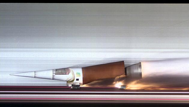

Quote Quote by Johninch View Post
The camera is not able to capture an entire picture at once.
Depends on the camera technology. A rolling shutter (film or CMOS) captures a portion of a picture at a time, which can create strange effects on fast moving objects, like what appears to be a bent spinning propeller. Wiki article include some examples of rolling shutter effects:
http://en.wikipedia.org/wiki/Rolling_shutter
A global shutter captures an entire picture at once. For high speed film capture, one way to get a global shutter effect is to use a very high speed strobe in an otherwise dark environment and no physical shutter. Example photo of a rocket sled moving at 3300 mph, captured with a single very bright and short duration flash:
What video devices don't do is provide images of continous motion. To prevent an "animated" look to film or video, the shutter speed is almost as slow as the frame rate so that moving objects leave a blurry trail across the image, called motion blur.
