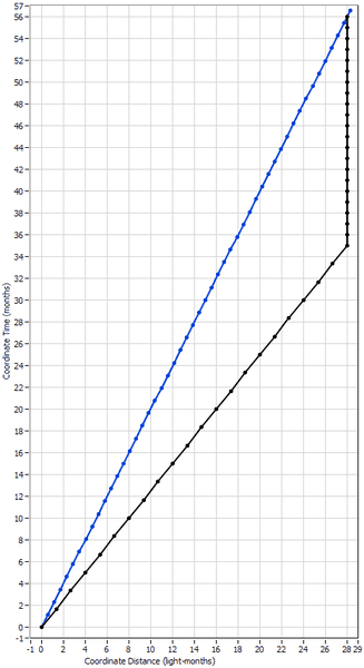

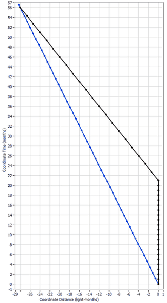

Btw, the key point why A and B measure different traveling times is not really the speed at which one of them travels (because from A's perspective it's B who is moving and from B's perspective it's A who is moving, so the situation is symmetrical). The crucial difference is the acceleration from one speed (B's) to another (A's first acceleration away from B, then after a time a new acceleration back towards B). The acceleration causes a change in frames of reference.
(This is the answer to the so-called twin paradox.)
ghwellsjr
ghwellsjr is offline
#9
Dec8-12, 04:47 AM
PF Gold
P: 4,526
Quote Quote by Warp View Post
It's true that B accelerates but that doesn't mean there must be a change in frames of reference in order to answer the so-called twin paradox. You can use any Inertial Reference Frame (IRF) and get the correct answer. Here are three IRF's based on the OP's first scenario at 50% of light speed to show you what I mean.
First, in the IRF in which both A and B start out at rest. B (black) travels at 50%c for 1 light-year and then returns. Note that it takes him 21 months according to his clock to get to Planet X and another 21 months to return. Since his speed in this IRF is 0.5c, his time dilation 1.1547 which means that the dots marking off each month are spaced slightly farther apart than the coordinate months. Meanwhile, A (blue) has aged by 48 months. (I have made B travel exactly 21 months to get to Planet X which is a little long and so A has aged a little long also.) B's total aging is 42 months while A's is a little over 48 months.
That is all that is necessary to explain the scenario. However, we can transform the entire scenario into another IRF and show it all over again. Here is the IRF in which B is stationary during his trip to Planet X. During this time, he is experiencing no time dilation and his months proceed in step with the coordinate time. However, A is traveling away from him at 0.5c according to the IRF so his time is dilated by the factor 1.1547. After 21 months, B turns around and heads for home. However, he now has to travel at 0.8c according to the IRF so his time is now dilated by 1.6667. When he arrives back home, A has aged slightly more than 48 months and B has aged 42 months, exactly like in the first IRF.
Now we can do another transformation and see what the scenario looks like in the IRF in which B is stationary for his return trip:
This looks very much like the previous IRF and the numbers apply in a similar manner so I won't go into the details.
Please note that each IRF is self-contained and explains everything about the scenario. Each IRF can easily handle the three accelerations that B experiences without the need to jump between frames or use a non inertial reference frame. If you want to claim that these IRF's do not explain the OP's scenario (or the so-called twin paradox) then I invite you to describe what you think is wrong with them and then produce your own detailed explanation and hopefully a plot to illustrate your explanation.
