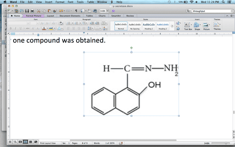

Could someone give the proper chemical names of the attached two compounds.
Lots of thanks in advance.

The second structure looks like the hydrazone of 2-hydroxy-1-napthalenecarboxaldehyde or 2-hydroxy-1-napthalenecarboxaldehyde hydrazone

For the second structure, chemspider.com loads the correct structure with the input name of 2-hydroxy-1-napthalenecarboxaldehyde hydrazone but it is also known as 1-hydrazonomethyl-2-naphthol. Your picture doesn't indicate which isomer, E or Z, it should be but if you were to include that, the name would also be 1-[(EorZ)-hydrazonomethyl]-2-naphthol.
