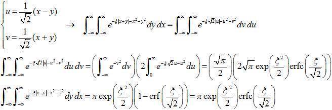

I have the integral
[itex]\int_{-\infty}^{\infty}dx \int_{-\infty}^{\infty}dy e^{-\xi \vert x-y\vert}e^{-x^2}e^{-y^2}[/itex]
where [itex]\xi[/itex] is a constant. I would like to transform by some change of variables in the form
[itex]\int_{-\infty}^{\infty}dx F(x) \int_{-\infty}^{\infty}dy G(y)[/itex]
the problem is that due to absolute value in the integral one must take in account where x is greater or less than y,
can someone help me, please?
First observe that
[itex]e^{-\xi \vert x-y\vert}e^{-x^2}e^{-y^2}=e^{-\xi \vert x-y\vert}e^{-(x-y)^2/2}e^{-(x+y)^2/2}[/itex]
Then you can either change variables such as
u=(x+y)/sqrt(2)
v=(x-y)/sqrt(2)
or break into two regions
x<y
x>y
Hi !
the clolsed form of the integral involves a special function (erf).
