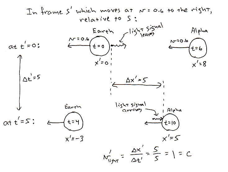

Quote Quote by klyde View Post
That 2nd postulate is giving me fits. Supposedly, it says that light's speed from point A to point B (in any inertial frame) is c, but I can't for the life of me see how this can happen. Would someone please provide an example using one or two inertial frames?
Here's my attempt at an example. Units of time are seconds. Units of distance are light-seconds (the distance light travels in one second). Therefore c = 1 which simplifies calculations.
In frame S we have the Earth and space station Alpha at rest, at x = 0 and x = 10 respectively. A light signal leaves Earth at t = 0 and arrives at Alpha at t = 10. Its speed is c = dx/dt = 10/10 = 1.
On the Earth and Alpha I have fastened clocks which are synchronized in frame S, and therefore display "S-time".
Now consider this from the point of view of frame S' which moves at speed v = 0.6 to the right, relative to frame S. In S', both Earth and Alpha move to the left with speed 0.6.
Notice the following:
Length contraction - the distance between Earth and Alpha is reduced by a factor of ##\sqrt{1 - 0.6^2} = 0.8##.
Time dilation - while 5 seconds elapse in S', 4 seconds elapse on both the Earth and Alpha clocks (that is, they run slower by a factor of 0.8).
Relativity of simultaneity - the Earth and Alpha clocks are out of synchronization; their readings always differ by 6.
In both frames, the light signal leaves the Earth when the Earth-clock reads 0, and it arrives at Alpha when the Alpha-clock reads 10.
In frame S', the light pulse's speed is c' = dx'/dt' = 5/5 = 1 = c.

klyde

jtbell
#18
Dec30-12, 09:29 PM
Mentor
jtbell's Avatar
P: 11,616
If, as you say, the clocks are not synchronized (in the 2nd view), then why not? (How did they become asynchronous?) (Did they become asynchronous due to the given assumption of the invariance of light's one-way speed? If so, then you are merely assuming that which you are trying to prove.)
My example is not an attempt to prove that the speed of light is invariant, merely to give an example of how distance and time measurements turn out in the two frames, in such a way as to make the ratio Δx/Δt come out to be the same in both, for a light pulse. I mistakenly thought that's what you were asking for.
As you're probably aware, the invariance of the speed of light is a fundamental postulate of special relativity, and as such cannot be logically proved or disproved from first principles, at least not in the usual derivation of SR from Einstein's two postulates. It can only be verified or disconfirmed by experiment, either by measurements of the speed of light itself, or by other tests of the entire theory that has been built on that principle.
