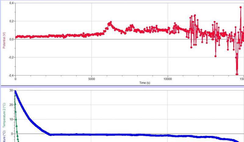

I used tap water for this experiment. I used a cable that has two ends to measure the voltage difference and put it inside the cup of water. The cable was attached to a LabQuest, and I graphed the change in voltage over time as the water froze. I voltage went up to 0.400 V and down to -0.200 V. I attached a screenshot of the graph.

So you had 2 pairs of stranded copper conductor immersed, to act as the probes? I think you had more than that immersed, too — how did you measure water temperature? Was it totally enclosed in plastic?

After skimming the article posted by K2 I'd GUESS there is well less than a one percent chance fractures in this case are the explanation.
[See "lab tests" section and decide for yourself.]
It appears that in lab settings, one must cause a temperature differential to the ice sample, apply a test wave and view it's characteristics, perhaps dope the ice, use of single crystalline samples [not sure what that is] and perhaps special detection setups like an electrode consisting 'of a massive copper substrate' to detect ANY voltage.
As an aside, galvanic reactions induced by typical probe metals in FRESH water would not
induce the magnitude of voltages reported here. One needs some ions, charged particles, to carry the current in water....even in sea water, those reported voltages seem high.
But in using, say, copper and zinc in sea water, an induced galvanic voltage of 900 mv..0.9... volts is typical: that's how zincs are used in cathodic protection. Those two metals are near opposite ends of the
of the metal NOBEL chart. An easy way to eliminate this effect is to dip two pieces of identical copper wire in the water as test probes....

I used a temperature probe as well. The water was in a Styrofoam cup.

I was hinting there may be galvanic action between the different metals in the different probes. Try leaving out the temp probe.

I tried that out yesterday. I just put the wires in, and left the temp probe out, but I still detected a similar voltage.

The voltage in a galvanic reaction is mostly independent of
the salt concentration. There is not much difference between salt and fresh water - which by the way also contains some ions. You will measure about the same voltage as long as your voltmeter has a sufficiently high impedance.

This is really crazy. I'm going to try and see if I can reproduce the results using distilled water closer to the beginning of next semester. I should be able to get a bit more control over what's going on over at the physics lab at uni.
