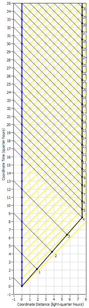

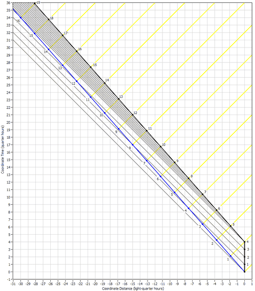

Gold Membership Gold Member
Quote by arindamsinha View Post
Quote by ghwellsjr View Post
1) Since the traveling twin's clock is essentially stopped during the trip, it will end up 10 seconds behind the Earth twin's clock when they do the synchronization verification test you described.
But having answered this, it doesn't help me understand what you are saying.
Thanks for taking this up and answering the question.
I was trying to establish that velocity-based differential aging between two bodies (and agreement on the same by both), is not dependent on the moving twin coming back to origin to be 'co-located' with the stationary twin to 'compare clocks'. It can be done at any point during the traveling twin's journey using light-signals.
This is not true. Here is a diagram that depicts a similar situation to the one you proposed except that it uses the same parameters as the one in post #33 but without the moving twin returning:
You are giving preference to this one frame, the Inertial Reference Frame (IRF) in which the "stationary" twin remains inertial. In this IRF, the differential aging after the moving twin comes to mutual rest with the "stationary" twin is 4.5 quarter hours (a little over an hour) with the moving twin younger. But look at this diagram in which the moving twin is inertial during his moving portion of the trip:
Here there is a different criterion for what is simultaneous and now the stationary twin is the one that is younger by slightly over 2 quarter hours (a little over a half hour).
Of course, every IRF will show the same results for whatever light signals are exchanged between the twins, but that is not sufficient to establish unambiguous simultaneity and that's what you have to do to determine differential aging. Differential aging is answering the question, between this coordinate time and that coordinate time, what is the difference in how two observers age? Even if the two observers agree with each other because they implicitly are using their mutual rest IRF, that doesn't mean the question has been answered the same for all other IRF's. The only way for all IRF's to get the same answer is if the two observers are colocated at the first coordinate time and again colocated at the last coordinate time, (not necessarily the same location, not necessarily even at rest in the same IRF nor do the observers even have to be in mutual rest at either time). All this is simply to remove any ambiguity about simultaneity issues at the start and the end of the process.
