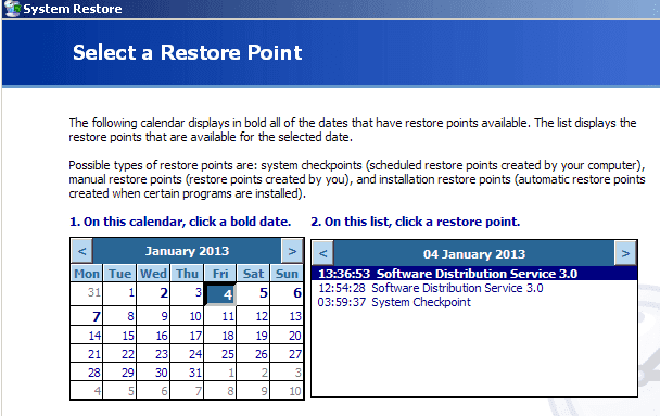

Can you get into Safe Mode and then do a System Restore to before when you trashed it? (Start menu - All programs - Accessories - System Tools)
That shouldn't delete any "user" files, but make a backup of anything important first just n case!
Haha, if only there were any backups to restore. :)
Windows System Restore should be on all the time by default. I didn't even know you could turn it off. Any time the Windows configuration changes, it automatically creates a "restore point". The attachment is from my XP system.
If you can get into safe mode, you can make a backup of all your dad's data files onto a USB memory stick or something. I would do that anyway, in case the problem gets worse!
