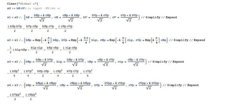

I was sent a .nb file with calculations already done for me, for various inputs.
I was wondering how I can edit those inputs, keeping the rest of the calculations the same, to find out what the result would be?
(see attached file for example)

All the lines with //Simplify // Expand are the rules I wish to keep. Its just the input s0 I wish to change, which will change what's under s2 and before s3... if that makes any sense?

Well that didn't turn out to be that hard... managed to get the calculation.
(Figured out that bH should be changed to -bH to convert H into - H)
It seems that displaying an output based on my input, running the calculation backwards, i.e. output -> input, turns up a different result.
Would that be an indication that my input (into what was there previously) has changed something?
[Equation 1: There is an input where it calculates an output.
Equation 2: Based on that output, I can insert that somewhere else where it will run the calculation backward and turn up the input I placed in Equation 1.]

See attached the .nb file, unedited with my own inputs (i.e. the file sent to me with already defined inputs).
Changing the first input from bH*cV to bV*-cH produces an output. Copying that output into the next calculation, where the input is defined as bHpp*cVpp, produces an output different to the input bV*-cH which was used for the top calculation.
It is difficult for me to understand exactly what you think the problem is.
One guess is that in your "forward" calculation you turn bH into bHp+I*cHp. In your "reverse calculation you seem to attempt to reverse that by subtracting I*cHp. That certainly seems like it would reverse the process. But in both cases you also divide by Sqrt[2]. That seems to break your attempt at reversing the process.
My guess is you need to multiply by Sqrt[2] to reverse the previous division by Sqrt[2].
This guess seem compatible with you appearing to end up with an extra division by 2 at the end of your attempt to reverse the process.
But you also end up with extra minus signs and powers of bH and cV.
I am guessing, but nothing more than that, that there are other little errors in your long chain of substitutions that attempt to reverse the process.
Does any of this make sense?
