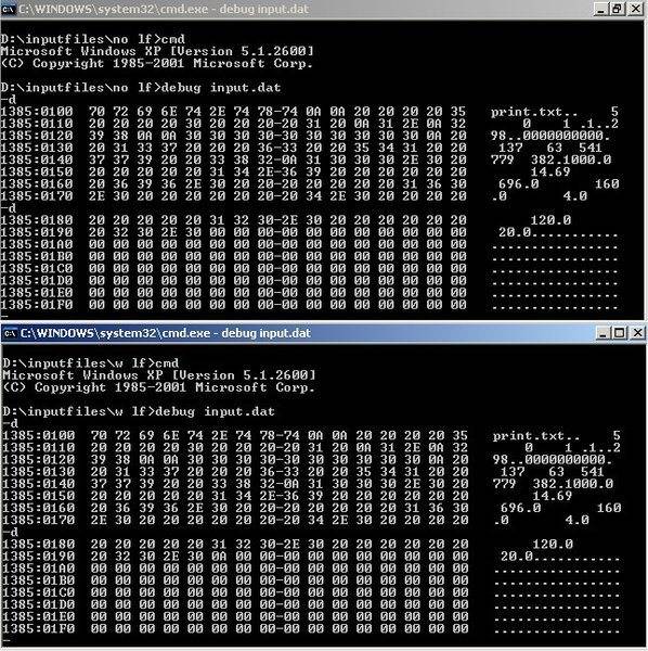

jelanier
jelanier is offline
#13
Jan31-13, 05:54 PM
P: 40
Quote Quote by Mark44 View Post
Operating systems handle ends of lines differently. IIRC, Windows adds a <CR> <LF> pair at the end of a line, while Unix and Linux add only a <CR> character.
That has not been my experience. The linux text editor I use only places a LF ($0A).
I saved the file with no "enter" at the end of the last line, and again with enter at the end.
The one with no enter, has nothing after the last character. The one with "enter" has only a LF ($0A) after the last character.
see attachment. (I used Leafpad in Debian Linux for this test)
Thanks,
Jim

gsal
gsal is offline
#14
Jan31-13, 08:58 PM
P: 838
As people develop their own editors, they can do whatever they want regardless of operating system and/or cater to both; in particular, if they are developing a multi-platform text editor....all you have to do is go to the settings and pick how you want your lines terminated: Windows or Unix style.
