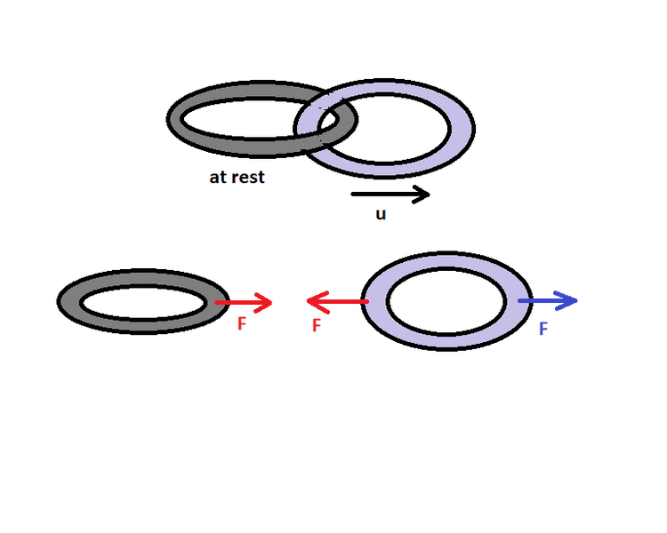

Suppose we have just 2 links each of mass m on a horizontal frictionless surface as shown. The right link is already in motion with speed u while the left link is still at rest. Let F Δt be the impulse that the right link gives to the left link to get the left link moving also at speed u. So, F Δt = mu. There will be a reaction impulse of equal magnitude acting to the left on the right link which we arrange to be exactly balanced by an external impulse (from the blue force) so that the right link maintains speed u. Then the work done by the blue force is F Δx = F(uΔt) =(F Δt) u = mu u = mu2 = twice the increase in KE of the system. So, more work was done by the blue force than shows up as KE.

  • #36
TSny said:
Suppose we have just 2 links each of mass m on a horizontal frictionless surface as shown. The right link is already in motion with speed u while the left link is still at rest. Left F Δt be the impulse that the right link gives to the left link to get the left link moving also at speed u. So, F Δt = mu. There will be a reaction impulse of equal magnitude acting to the left on the right link which we arrange to be exactly balanced by an external impulse (from the blue force) so that the right link maintains speed u. Then the work done by the blue force is F Δx = F(uΔt) =(F Δt) u = mu u = mu2 = twice the increase in KE of the system. So, more work was done by the blue force than shows up as KE.
Now that I agree with. Picking up the links is an inelastic process.
