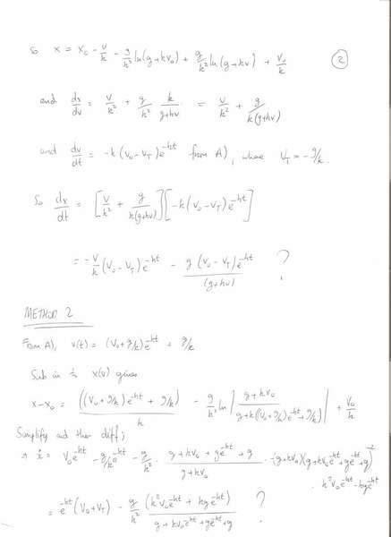

A particle of mass ##m## is projected from ##x(0) = x_o## in the vertical direction, with an initial velocity, ##\dot{x}(0) = v_o##. It is subject to gravity and linear drag, mk|v|, against the motion.
1) Show that the body follows ##v(t)## such that:$$v(t) = -g/k + (v_o + g/k)e^{-kt}$$
2) Use ##\ddot{x} = v dv/dx ## to find a soln to the motion subject to the initial condition. Show the equivalence between the result attained and the one shown in 1).
Separable Diff Eqns, Newton 2nd
1) is fine. I don't really know how to show the equivalence, but I have tried two different ways, where one way I get nothing near equivalence and the other I recover the exp term above, but not the -g/k in front.
Method 1). After solving ##\ddot{x} = v dv/dx, ##I get ##x = x(v)##. Then by the chain rule, ##dx/dt = dx/dv\,dv/dt##. So I differentiated my soln in 2) wrt v and then multiplied this by the derivative of v wrt t in 1). This gives me nothing near equivalence, although I am not sure why.
Method 2). Put v = v(t) in 1) into my x(v). This gives x(t). Then simply differentiate wrt t. I get the second term in 1) (exp term) but not the -g/k.
Both methods seem valid, (are they?) but I don't get the result. I could recheck my algebra again, but both methods yield a (g +kv)^3 and that is not present in 1) and it doesn't cancel.
Many thanks.

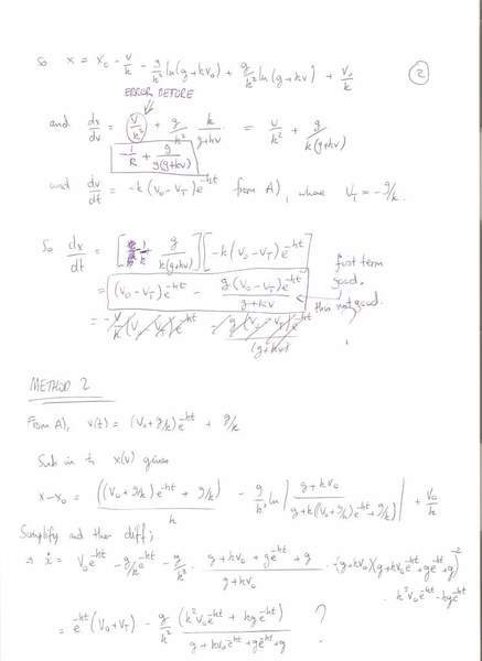

Working in pen:

I don't see where the second equation on page 2 comes from. It's dimensionally wrong. k has dimension 1/T, LHS = dx/dv has dimension T, on RHS v/k2 has dimension LT and g/(k(g+kv)) has dimension T.
I see. But what did I do wrong? All I did was differentiate wrt v, and so the terms not containing v just vanished.
EDIT: I made an error there - i see. Thanks for pointing this out. I'll recheck things.
Fixing my error above only removes the v/k term that I had in front of the exp term so I recover the ##(v_o + v_T)exp.. ##term but not the other one..

So taking the derivative of the first line:
dx/dv = -1/k + g/(k(g+kv))
Multiply this with dv/dt obtained from A) (shown in the image) gives me the term (v_o -v_T)exp but not the '+v_T' term.
Many thanks.

The procedure you describe works for me, so you will need to post ALL your working.
Ok, I will post all my working momentarily. But how would you get that +v_T? In the dx/dv, I have a g/k(g+kv) term , so how when multiplied by dx/dt will I get anything near a simple +v_T?
EDIT: Working attached
And that second line should read ##-\frac{1}{k} + \frac{g}{k(g+kv)}, ## not ##-\frac{1}{k} + \frac{g}{g(g+kv)}, ##
You're missing that you have v on both sides of the equation (as dx/dt on the left). You need to rearrange it so that v is only on the left. Btw, the expression for dx/dv can be simplified a lot.
I see, thanks. But what about method 2) (also contained in same link). I don't think I made the same mistake there. Thanks
In the very first line after "METHOD2" you have the wrong sign on the g/k term at the end of the line. It must be vT, so that it tends to vT as t tends to infinity, and vT = -g/k. If you fix that there'll be some cancellation.
