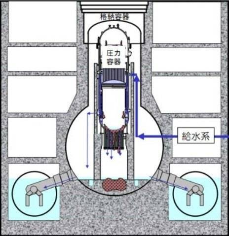

Quote Quote by Kutt View Post
Have they concluded whether or not the cores have burned their way through the concrete base of the reactor building and into the Earth beneath it?
Thankfully, concrete base is about 10 meters thick.
Models so far say that corium almost reached the containment bottom (the light-bulb shaped thing), and if they are wrong, it may indeed reached it, but there are 7.5 more meters of concrete below it.

Kutt
