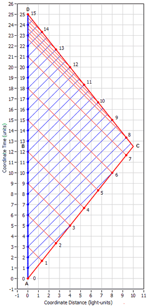

I decided that I ought to do the calculations that I should have done Friday night, before reading any of the posts or papers referenced since then. Here's my best shot at the Twin Paradox. Later this evening, or maybe tomorrow night, I'll see how what I did compares with your suggestions.
I can't say that I did this without any outside influences since Friday night. I did see that the image that George referenced looks like a spacetime diagram. That may have triggered some thoughts about coordinates.
I do all the calculations for the spacetime diagram but did not include an image of it. You all know what it looks like.
Solution of the Twin Paradox - to the degree possible knowing only the Lorentz transform and the usage of the spacetime diagram.

Four spacetime events will be considered.
Event A: Corresponds to G2. Time and position are zero in both the Earth frame and the rocket frame. Velocity of the rocket frame is V. For convenience, the axes are set so that positive V is along coordinates ; positive V is made to be along the for convenience . For the moment, the Earth frame will be shown with orthogonal the velocity will be shown "to the right" on the spacetime diagram,
Event B: Corresponds to G4, on the worldline of the Earth.
Event C: Corresponds to G4, on the worldline of the rocket.
Event D: Corresponds to G6. The worldlines of the Earth and rocket meet here, and become colinear.

Answers to questions:
Q1. Both the Earth and the rocket claim to be at rest throughout the episode. Can both make good on this claim?
Yes, kinematically. Earth and rocket X coordinates are 0.0 throughout.
Whether this makes physical sense dynamically is unknown, given limited knowledge noted above.
Q2. What are the clock readings on Earth and rocket at G6?
The Earth clock reads 25.0.
The rocket clock reads 15.0.
Q3. Are the clock readings calculated for Q2 unambiguously unique?
Yes. There is only one way to construct the spacetime diagram, due to the unique non-inertial behavior of the rocket.
Visually, the Earth and rocket experiences are symmetric. Each sees the other move away and return. Nevertheless, the rocket is unambiguously younger than the Earth at reunion.
Feb17-13, 03:37 PM   #141
Recognitions:
Gold Membership Gold Member
Quote by GregAshmore View Post
The Earth can claim to be at rest in an inertial frame. The rocket can claim to be at rest in a non-inertial frame.
Correct.
Yes.
Correct.
I don't know why you would say this. Are you referring to the Earth's inertial rest frame? There are an infinite number of ways to construct spacetime diagrams for your scenario, all with different velocities with respect to each other and all just as valid and all producing the same final clock readings and the same things that each observer actually sees.
No, they are not symmetric. The rocket sees the Earth move away at 0.8c for a distance of 3.333 units and then remain at that distance for some time and then come back to the rocket. But the Earth sees the rocket move away at 0.8c to a distance of 10 units and then immediately start coming back. It doesn't matter what spacetime diagram you use to depict your scenario, they are all just as valid and produce the same results. The only thing that is different in them are the values of the coordinates (and the geometric shapes of the worldlines).
Given:
G1. Earth and rocket are both at rest at same position. Earth clock and rocket clock are synchronised.
G2. At time 0.0, rocket fires a pulse.
G3. Earth and rocket separate at relative velocity 0.8c.
G4. At distance 10 units from Earth, as measured in Earth frame, rocket fires a pulse.
G5. Earth and rocket approach at relative velocity -0.8c.
G6. Upon reaching Earth, rocket fires a pulse, coming to rest on Earth.
G7. Gravitational effects of mass are to be ignored.
Here is a spacetime diagram for Earth's inertial rest frame:
Earth is shown as the wide blue line and the rocket as a wide red line. Dots along each path indicate one unit of elapsed Proper Time and I have marked most of them. I have also marked the four events that you indicated.
Here is a diagram to show the rocket at rest:
Both Earth and the rocket send a signal to the other one every unit of Proper Time. These signals provide the information that accounts for the visualization that you mentioned at the end of your post. The diagrams make it obvious that the situation is not symmetrical between the Earth and the rocket. They also make it clear that either diagram will provide all the information to determine the visualization of either observer.
You should track a few of the signals, noting the Proper Time (according to the dots) they were sent and received and then go to the other diagram and confirm the same information.
I didn't necessarily use the same coordinates that you used but, again, this will have no bearing on any outcome. The Coordinate Times are not significant when comparing between frames, only the Proper Times matter.

Quote by ghwellsjr View Post
I was too general in my wording. I only meant that Events A, B, and C have been placed, there is only one way to place Event D.
Again, poor choice of words. "Similar" would have been better than "symmetry".
