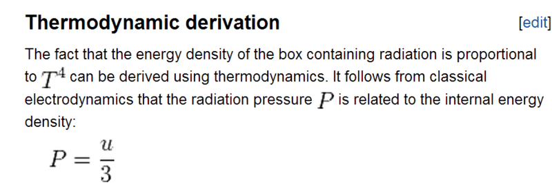

How to relate the radiation pressure to the internal energy?
The discussion revolves around the relationship between radiation pressure and internal energy, specifically exploring how to derive the formula P = u/3 for electromagnetic radiation in equilibrium. Participants examine various theoretical approaches, including kinetic theory and classical field theory.

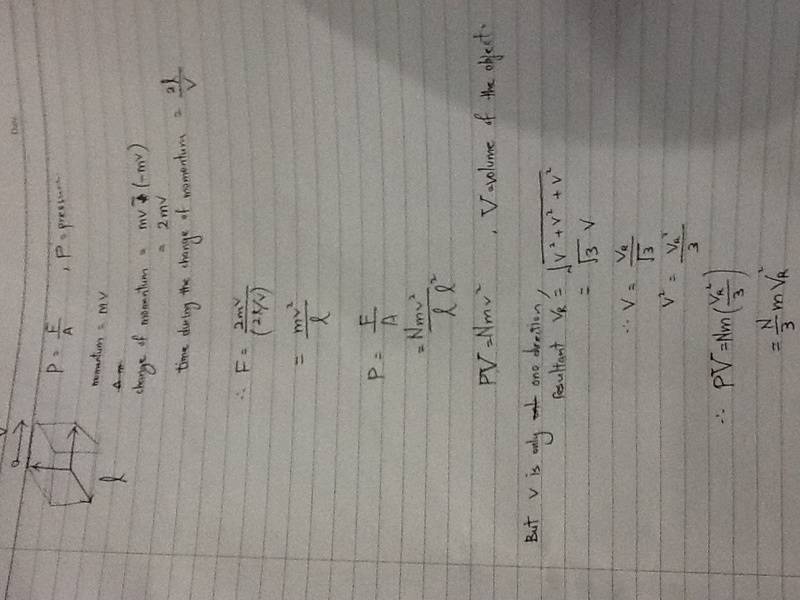

This is the derivation I found. But I don't understand how can the time for the change of momentum is so large? Why is not the moment when it changes momentum but the time between collision.
But I think you may have better derivation , can you please guide?
Thank you

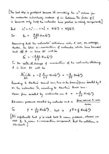

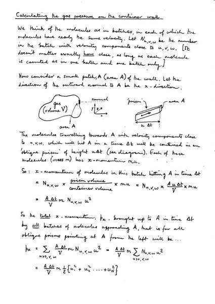

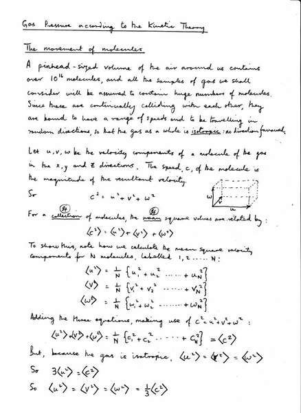

I'll deal just with molecular gases, not photons. The molecular gas treatment can be adapted to photons as explained earlier.
1. Dividing by the time for a collision to take place would give you the mean force exerted by a molecule on the wall when it's colliding. But that's not what you want. You need the mean force on the wall all the time, whether or not a molecule is in the process of colliding.
2. I'm not fond of the derivation you give, though it was the standard one given to A-Level students in the UK, in the days when exam boards still required a derivation to be known. Students, quite reasonably, disliked the restriction of the cuboidal container, and the notion of a molecule bouncing back and forth between opposite walls, unimpeded by other molecules.
The derivation in the thumbnails below is, in my opinion, far superior. It is my version of a derivation I first met in a very old book, The Kinetic Theory of Gases by Sir James Jeans. Note that, in the thumbnails, I'm using u to mean x-wise velocity component, not energy per unit volume!

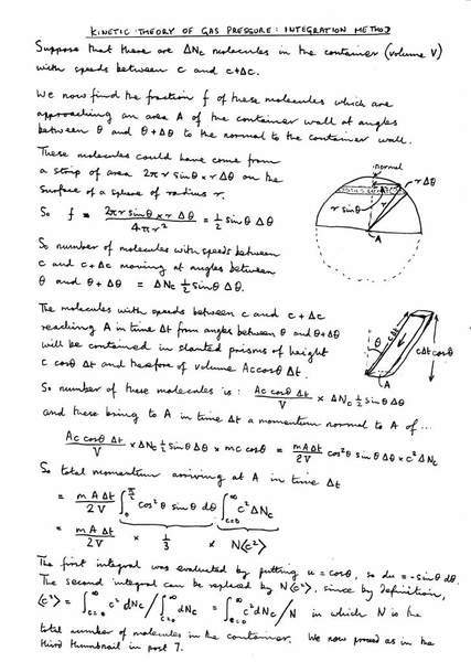

If you're happy with a bit of integration, there's another version of the Jeans argument which you might prefer. It deals differently with the 'grouping' of molecules by velocity.

Really thank you. One thing to ask why do the total momentum need to times prism volume / V ?
Can you please upload the integration one? Thank you.
(prism volume)/(container volume) is the fraction of the Nu,v,w molecules (with the relevant velocities) in the whole container which are in the prism, and therefore which will hit area A of the wall in time [itex]\Delta t .[/itex]
Yes, I'll post the integration method soon.
As promised...
Thank you for uploading .
We integral the theta from 0 to pi/2 because we consider that strip volume can be a semi sphere?
Exactly so, except that it's area, not volume.
Yup, should be area. Really thank you.
