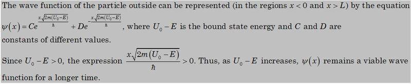

The discussion focuses on the behavior of wave functions in a finite potential well as the energy of a bound state increases. The wave function inside the well is represented as Asin(lx) + Bcos(lx), while outside the well it is expressed as Fe^(-ka), where k is defined as Sqrt[-2mE]/hbar. As energy increases, the exponent becomes less negative, resulting in a wave function that extends further outside the well, thereby increasing the probability of finding the particle outside the barrier. This phenomenon is corroborated by the transmission coefficient calculations, illustrating that higher energy states correspond to greater tunneling probabilities.
