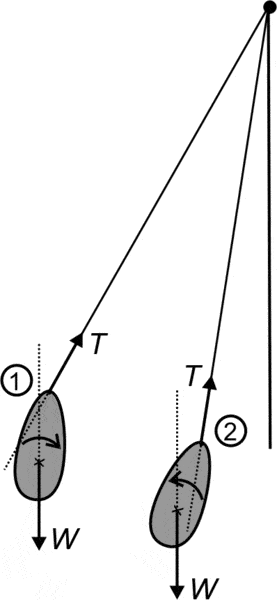

In the drawing you can see that the tension tends to rotate the mass, both at points one and two in the motion, around the com, in such a manner that the point of application of the tension and the com are brought in line with each other.

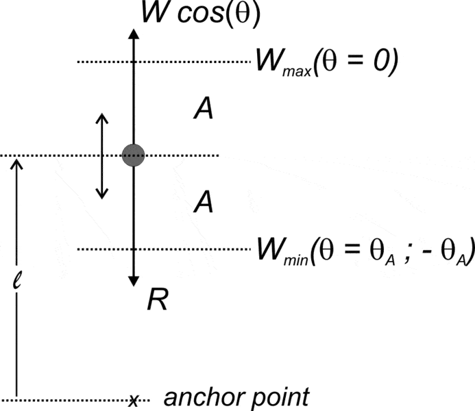

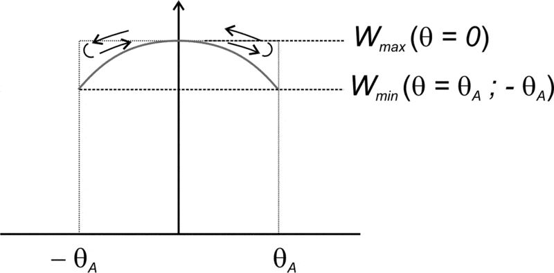

In attachment 1 we are looking at the motion of the mass along the line of the string. It is experiencing two forces along the direction of the string, the [itex]W\cos(\theta)[/itex] component of its weight and the restoring force [itex]R[/itex] of the spring. This weight component varies between a minimum [itex]W_{min}[/itex] and maximum [itex]W_{max}[/itex] as the pendulum swings between its amplitudes [itex]\theta_A \ and \ -\theta_A[/itex] as shown in attachment 2. As the component of the weight therefore varies between its minimum and maximum values the mass will therefore oscillate along the line of the string with amplitude [itex]A[/itex]. The pendulum will therefore be at its longest when at [itex]\theta=0[/itex] with a length of [itex]l+A[/itex] and at its shortest when at [itex]\theta_A \ and \ -\theta_A[/itex] with length [itex]l-A[/itex] - see attachment 1. The position of the mass as it swings to and fro will therefore be as showm in attachment 3. Clearly it is not possible for it to stay on the same level during its swing.

The mentioning of amplitudes A in my previous post implies that the motion of the mass along the line of the string is SHM, something that I did not investigate. Therefore one should rather think of a single extension of the spring from the the one extreme position to the other. The rest I stand by unless someone is so kind as to convince me otherwise.
