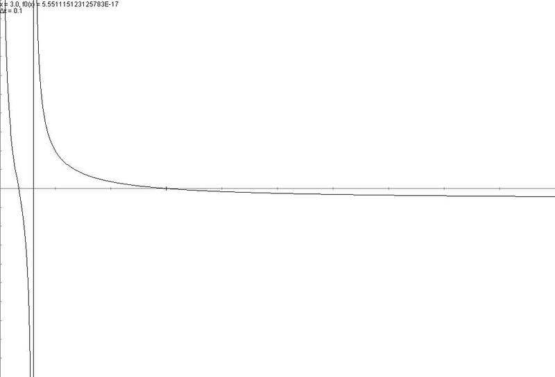

Does anyone know the equation to see the return time given an arbitrary speed? I've been trying to make one but it's giving me non-sensical answers.
[tex]t_b = t_t+ \frac{1-k'(u/c)}{k'c - u}(x_r-x_b) + \frac{x_r-x_t}{kc}[/tex]
t_t = transmit time
t_b = return time
x_t = transmit location
x_r = receiver location
x_b = return location
k = ftl constant for ftl test observer
k' = ftl constant for the other inertial observer
u = relative velocity between test and other observer
Not only is this giving me positive return times no matter how fast the k, but k lower than the speed of light result in time travel, or is completely undefined. I'll post by derivation if anyone is seriously interested in finding the problem. But I figure it's already been done somewhere.

Just to be clear, is the first observer at rest relative to the emitter? And is the reply signal moving at k' in the second observer's frame, while the original signal moved at k in the first observer's frame? If not, can you specify what k and k' are the velocities of?
Observer A has a transmitter at x_t and a receiver at x_r set to send a signal in the +x direction. And observer B moves at u in the +x direction relative to A which has a transmitter and receiver set the send a signal in the -x direction.
B's transmitter is set to pass A's receiver located at x_r at time (x_r - x_t)/(k*c). So k is the multiple of c that the signal is traveling. The signal is then resent by B to it's receiver in it's frame. k' is the same thing but in B's frame. They can be the same but I made them separate just for generality. B's receiver will be at x_b at time t_b when the signal is received. I'm not concerned about B's reference of the events. Essentially when B's receiver gets the signal at t_b it broadcasts it at c in A's frame, so x_b could be anywhere, although we're mostly interested when x_b = x_t (same starting and stoping point).
Probably the simplest approach here is just to figure out how fast a signal will be moving in your frame if it is moving at k'c in the -x direction of a frame that is moving at u in a +x direction relative to you.
Say that in this other frame, a signal is emitted at x'=0 ,t'=0 and after a time interval of t0 in that frame it is at x'=-k'*c*t0, t'=t0. We can use the Lorentz transform to find the coordinates of these events in our frame:
[tex]x = \gamma (x' + ut')[/tex]
[tex]t = \gamma (t' + ux'/c^2)[/tex]
with [tex]\gamma = 1/\sqrt{1 - u^2/c^2}[/tex]
So the coordinates of the first event are x=0, t=0 while the coordinates of the second are [tex]x = \gamma (-k'ct_0 + ut_0) = \gamma (u - k'c) t_0[/tex] and [tex]t = \gamma (t_0 - uk't_0 /c) = \gamma (1 - uk'/c) t_0[/tex]. So, the speed is distance/time, or (u - k'c)/(1 - uk'/c). You could also find this just by using the formula for velocity addition in relativity with v = k'c.
Since k'c is faster than light and u is slower, no matter what k and u are we know the numerator u - k'c will be negative. The denominator will be positive when the signal is moving forward in time, negative when it's moving backwards in time. So if we know the signal was emitted by B at position [tex]x_r[/tex] and time [tex]t_r[/tex], and it had to go a distance of [tex]x_r - x_b[/tex] to B's receiver, then it should reach B's receiver at time [tex]t_r + (x_r - x_b)/(-v_b)[/tex], where [tex]v_b = (u - k'c)/(1 - uk'/c)[/tex] which again should be negative when the signal is moving forwards in time, which you can see from the above formula means the signal reaches B's receiver at a time greater than [tex]t_r[/tex], and positive when the signal is moving backwards in time, which means the signal reaches B's receiver at a time less than [tex]t_r[/tex].
So, all that's left is to note that [tex]t_r = (x_r - x_t)/kc[/tex] as you said earlier, and I would conclude that [tex]t_b = (x_r - x_t)/kc + (x_r - x_b)(1 - uk'/c)/(k'c - u)[/tex]. This is the same thing you got, except for that extra [tex]t_t[/tex] in yours which doesn't fit with the statement that the first signal will reach A's receiver at [tex](x_r - x_t)/kc[/tex]...if you wanted the original signal to be sent at an arbitrary time [tex]t_t[/tex], then that should be [tex](x_r - x_t)/kc + t_t[/tex]. Apart from that minor issue I don't see a problem.
Oh ya, I meant [tex]t_r = t_t + (x_r - x_t)/kc[/tex]. I see now that the graph actually does make sense. I got scared by the undefined part when k*c <= u. But I guess that makes sense since if B tried to send a message back to [tex]x'_t[/tex] slower than the relative velocity it wouldn't make it.
Graph:
[tex]t_b[/tex] on vertical and [tex]k=k'[/tex] on the horizontal where [tex]x_r - x_t = x_r - x_b = 1cs[/tex] (1 light second), [tex]t_t = 0[/tex] and u = 0.6c. It does (edit: it already violated causality in B's frame. I'm concerned with A's perspective) start time traveling around k > 3.
Thanks,
