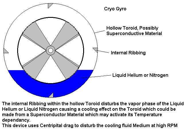

I wonder how cold something like this could get.
I don't know what you're trying to do, but liquid nitrogen is probably cheaper than anything you're trying to do at home. I'm sure I get some slight institutional discount, but I pay about 50 bucks for 60 gallons. I don't know if they have rules against home deliveries. Dry ice will get you close, around -79 C, and is easy to get.
