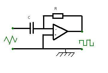

I have to propose a circuit that converts a triangular wave potential waveform to a square wave potential waveform, that has a T=10ms and Umax= +4V (the triangular curve has the same T and Umax)
We have a capacitor of 4micro Farad and 3 resistance (1kΩ ; 250Ω ; 500Ω) andyou should use only one resistance.
So, I know it's this one: (attached)
But I have to find what resistance to use.
[tex]\ V_{exit}= \frac {4RCV_{max}}{T}[/tex]
I need that [tex]\ V_{exit}[/tex] (that I don't have) to solve for the R !
Any help please ?!
