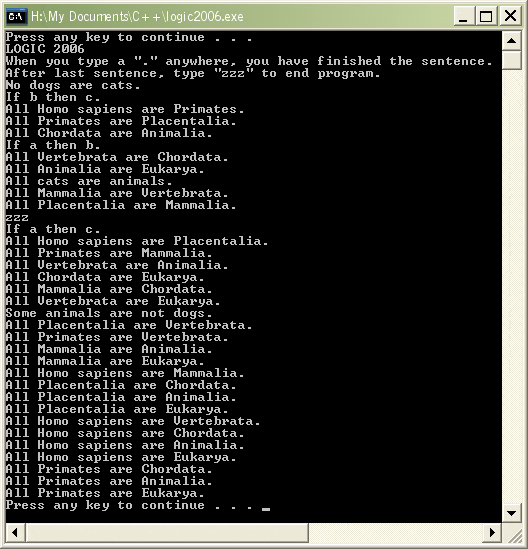

Hi. I would like some comments on my artificial "logician". So far it is limited to syllogisms, where you type in a phrases such as "No dogs are cats" and "All cats are animals" and then the program prints out phrases such as "Some animals are not dogs". There is a more impressive demonstration of an earlier version of this program in the attached image.
I am a sophomore at the University of Houston, and I plan to major in Computer Science with a minor in Physics and Math.
Logic2006.cpp

    cout<<"LOGIC 2006\n";
    cout<<"When you type a \".\" anywhere, you have finished the sentence.\n";
    cout<<"After last sentence, type \"zzz\" to end program.\n";

And this is the old version:
logic.cpp

                  cout<<"If"<<ifthen[i].a<<" then"<<ifthen[j].b<<"."<<endl;
                  it++;
                  strcpy(ifthen[it].a,"");
                  strcpy(ifthen[it].b,"");
                  strcat(ifthen[it].a,ifthen[i].a);
                  strcat(ifthen[it].b,ifthen[j].b);
              if(itncmp)
                  cout<<"Not"<<ifthen[i].b<<"."<<endl;
                  no++;
                  strcpy(nOt[no].w,"");
                  strcat(nOt[no].w,ifthen[i].b);
              if(itincmp)
                  no++;
                  if(strlen(ifthen[i].i2)>0)
                      cout<<"Not"<<ifthen[i].i2<<"."<<endl;
                      strcat(nOt[no].w,ifthen[i].i2);
                  else
                      cout<<"The following statement is "<<ifthen[i].b<<"."<<endl;
      cout<<"Would you like try another sentence (say yes if you agree)?... ";
      cin>>c;
  }   while(strcmp(c,"yes")==0);
  system("PAUSE");
  return 0;

Nice Job!
I haven't gone through your code, but the output is pretty good. For further development, you may like to try to get your hands on the following papers,
1] Newell A., Shaw J.C., Simon H.A., (1959). Report on a general problem-solving program. Proceedings of the International Conference on Information Processing. pp. 256-264.
2] Newell, A. (1963). A guide to the general problem-solver program GPS-2-2. RAND Corporation, Santa Monica, California. Technical Report No. RM-3337-PR.
3] Ernst, G.W. and Newell, A. (1969). GPS: a case study in generality and problem solving. Academic Press.
For the time being, you may like to read this article,
http://www.cog.jhu.edu/faculty/smol...tions Readings PDFs/Newell&Simon-1963-GPS.pdf
I assume that you are pursuing to write this programs out of sheer fun. In case you are being serious about doing something on this, i would like to warn you that working with syllogisms went to its limit at one point and hence the approach was abandoned at some point after the 1960's.
At the same time, i would like to encourage you to look at statistical inference mechanisms. Especially, combining statistical methods with semantic constraints is a hot topic in research.
Anyways, good job! :)
-- AI
I strongly recommend that you learn to use some kind of a lexer/parser, then separate the "computational" part of your code from the lexer/parser.
I'd look into ANTLR and StringTemplate. You can use these tools to generate lexers and parsers based on simple (but powerful) grammars. You can then just walk the resulting syntax tree to perform your computations, all in one simple, abstract block of code. The entire "meat" of the code you provided here is probably only a few dozen lines; the rest is all parsing.
Just my $0.02. Learning ANTLR (or related tools like flex and bison) would be very beneficial for any programmer. In the "real world," few people write their own parsers unless there's a very strong reason they must.
- Warren
