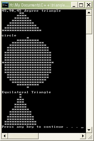

Hello,
I am trying to print an equilateral triangle, made up of * (stars), of height 8. Can someone please give me some hint. I am not getting the desired output. Thank you. Here is my code.

jacy said:
Hello,
Please show us exactly what this triangle is supposed to look like, by literally typing it out inside a (code)(/code) block. (square brackets instead of parentheses, of course).
