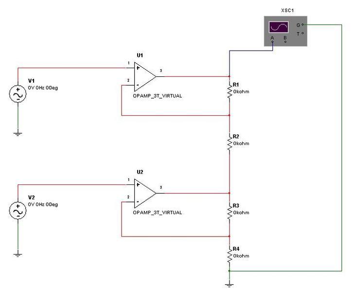

So, here's the deal:
The professor that normally handles Electronics 1 and Electronics 2 went on sabbatical for a year, so the engineering department brought in a guest lecturer to handle it during his absence. The original electronics professor would do op-amps in electronics 1, and BJT's and FETs in electronics 2. The guest lecturer came in and did only BJT's in electronics 1, and now that the resident instructor is back from sabbatical, he's doing BJT's and FETs.
We told him that we hadn't covered a single practical op-amp yet, so he's been trying to use or lab time to condense an entire semester of op-amps into 3 hour periods on wednesday afternoons.
He gave us the attached homework problem on op-amps. What he told us was:
The CMRR of Op-Amps 1 & 2 are equal and are finite.
A) What is the expression for V_out
B) What is the relationship between the various resistors for the output to be proportional to the difference of V1 and V2?
V_out is taken at the node right above R1, as shown by the oscilloscope.
I'm not entirely certain how to approach this problem. In all the examples we've worked in class, I've never seen an op-amp circuit connected this way.
Any help you could give would be greatly appreciated.
No values were given; he wants the answer in algebraic form.

So for your circuit you can analyze it like this. If you set v1 to 5 volts, then output pin 3 of U1 will have to force the feedback loop to make the voltage difference between pin 1 and 2 zero, so pin 2 has to be 5 volts also.
If you know R1, or the current, your could calculate the ouput put voltage at 3.
It's a trick question. The outputs of the opamps are shorted together and shorted to ground. Vout = 0V.
With other resistor values and non-zero excitation, then analyze the circuit the way what is explaining.

Look at it this way. There are two sources of current I1 and I2 from the op-amps. The voltage at the junction between R4 and R3 is V2
[tex]V2 = R4(I1+I2)[/tex]
The voltage at the junction of R1 and R2 is V1 (because v+=v- of the op-amps).
[tex]V1 = R2 I1 +R3(I1+I2)+V2[/tex]
The output voltage is:
[tex]V_ = V1 + R1 I1[/tex]
So, I get:
[tex]V_ = V1(1+R1/R2)-V2[(1+R3/R4)R1/R2][/tex]
For the output to be proportional to V1-V2 the coefficients have to be equal:
[tex]V1(1+R1/R2)= V2[(1+R3/R4)R1/R2][/tex]
In other words:
[tex]R1R3 = R2 R4[/tex]
Paul Deichelbohrer

I ran the circuit again in MultiSim, and I've found that Vout is only 0 if all the circuit elements are equal, i.e., V1 = V2, R1 = R2 = R3 = R4. If you change these values, Vout changes accordingly. Berkeman, could you explain to me how this might be correct or incorrect? I am not challenging your statement, I am trying to better understand why it should or shouldn't be 0 at the output.
Paul, I came up with a slightly different answer from what you had. Can you expand your derivation more so that I can see the steps between your answers?
I used superposition to get the following:
Replacing V2 with a short makes U2 an inverting op-amp with respect to V1:
Vout_1 = [(1 + R1/R2)*V1] + [(-R3/R4)*V1]
Vout_1 = V1*[(1 + R1/R2) - (R3/R4)]
Replacing V1 with a short makes U1 an inverting op-amp with respect to V2:
Vout_2 = (1 + R3/R4)*V2 + (-R1/R2)*V2
Vout_2 = V2*[(1 + R3/R4) - (R1/R2)]
Vout = Vout_1 - Vout_2
Vout = V1*[(1 + R1/R2) - (R3/R4)] - V2*[(1 + R3/R4) - (R1/R2)]

There are only two sources of current, the op-amps. I called the current from U1, I1, and the current from U2, I2. I assume there is no current in the lead to the oscilloscope nor in the leads to the negative inputs to the op-amps.
You HAVE to believe that v+=v- for the op-amps. Therefore, the junction between R1 and R2 is at voltage v2. Op-amp U1 produces current I1 which produces a drop across R1, so the voltage at the oscilloscope (output voltage) has to be v1+R1 I1. (~~~)
I1 goes through R2, so the output terminal of U2 has to be at voltage v1-I1 R2.
Through R3 we have both I1 and I2 flowing so the voltage at the junction between R4 and R3 has to be below that of U2's output terminal by an amount R3(I1+I2). However, this point (junction between R4 and R3) is at voltage v2 because v+=v- for U2 (just as it was for U1). So I sum the voltage drops to get:
v1=R2 I1 + R3(I1+I2) + v2. (****)
Both I1 and I2 flow through R4, so v2 = R4(I1+I2).
To solve these, first, I solve for:
I1+I2 = v2/R4
I substitute this expression into Eq. (*****):
v1=R2 I1 + R3(v2/R4) + v2
From this I get I1:
I1 = (v1-v2 - v2 R3/R4)/R2 = v1/R2 - v2(1+R3/R4)/R2
Like I said back at (~~~~), the output (v_) is v1+I1 R1, so,
v_ = v1+v1R1/R2-v2 R1(1+R3/R4)/R2
= v1(1+R1/R2) - v2(1+R3/R4)(R1/R2) (&&&&&&&&&)
I believe this is the expression I had for output voltage in my post of 4/19.
For the output voltage to be proportional to v1-v2, the relationship has to have the form:
v_ = k(v1-v2) where k is some constant of proportionality.
Multiplying this out:
v_ = kv1 - kv2
Comparing this expression with &&&&&&&&:
k has to be equal to (1+R1/R2) and also (1+R3/R4) (R1/R2). In otherwords, both expressions have to be equal to each other:
1+R1/R2 = (1+R3/R4)(R1/R2)
1+R1/R2 = R1/R2 + (R1R3)/(R2R4)
canceling R1/R2 from both sides:
1 = (R1R3)/(R2R4)
Multplying by R2R4, I get:
R2 R4 = R1 R3
I hope this helps. Let me know if it does or doesn't. Also, let me know what I'm doing wrong to get a thumbnail on my post.
Thanks.
Paul

Well Paul, it looks like I still need some help :).
I tried analyzing the circuit writing 3 KCL equations (1 for the node between R1 & R2, 1 for the node between R2 & R3, and 1 at the node between R3 & R4), and I was able to get the same answer as you. I was happy with that.
Then I went and spoke to my prof., and he pointed out that an important consideration was neglected: these are not ideal op-amps
He said that the CMRR must be taken into account for these calculations, and sort of told me how to look at it, but I think I'll still need some help.
Any ideas as to how approach this?

vo = vi (1+ Rf/Ri)(1 + 1/CMRR). I went through the math that they give, and I don't see anything wrong with it.
In your circuit, first consider v1 = 0. Then, U1 is an inverting op-amp with input resistor, R2 and feedback resistor, R1. U2 is a non-inverting op-amp that is driving U1. (I believe you were trying to get me to see the problem this way a couple days ago)
So the output voltage of U2 is V2:
V2 = v2 (1+R3/R4)(1+1/CMRR).
And, the output of U1 is:
V'_ = -V2 R1/R2, since there is no CMRR effect in inverting op-amps.
With the v2=0, U1 becomes a non-inverting op-amp, so it's output, V1:
V1= v1 (1+ R1/R2)(1+1/CMRR), since it's input resistor, R2, is grounded by U2.
Using superposition, like I believe one of your earlier authors to this thread suggested,
V_ = V1 + V'_ = v1 (1+ R1/R2)(1+1/CMRR) - v2 (1+R3/R4)(1+1/CMRR)R1/R2.
To be proportional to v1-v2:
(1+ R1/R2)(1+1/CMRR) =(1+R3/R4)(1+1/CMRR)R1/R2
1 + R1/R2 = R11/R2 + R3 R1/(R2 R4)
R1 R3 = R2 R4.
I did this in kinda of hurry. Let me know what you find wrong, or if I should explain more.
This is correct, Paul.
Except our professor is having us use (1-1/CMRR) instead of (1+1/CMRR). I'll have to try to find out why that is different...
Essentially, it's the same answer as before with the ideal op-amp model but with the CMRR coefficient in front.
Thanks again for your help!
I looked at my notes and the web site, and I believe it should be
1+1/CMRR. I'll be interested to find out why it is negative.
Thanks for keeping me informed.
See if this thumbnail comes through. (I guess it won't because my bitmap is too big. 407kbyte. Has to be less than 100 k bytes.)
