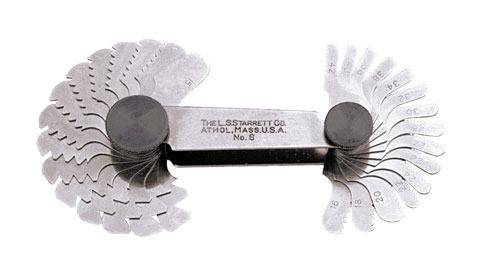

The pitch can also be thought of as the distance from peak to peak or crest to crest of adjacent threads. Now, when you say "one main scale division" what kind of thread gauge are you referring? I am used to seeing the types of gauges that you physically hold against a fastener to compare the thread engagement (similar to attached pics). What scale are you referring? It also helps to know what kind of screw thread type you are referring to.
http://www.mcfeelys.com/images/prodimages/dg-0014.jpg

What you have is a micrometer screw gauge, or just plain micrometer (as opposed to screw or thread gauge, which usually refers to the thing that FredGarvin posted):
