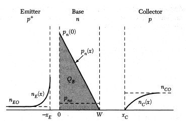

I realize that this thread is 5 years old, but I spent a bit of time thinking about it, and feel that I can add a little more physical clarity for anyone who searches and finds this thread. I will discuss a pnp transistor with geometry as per figure 5.6 in Sze (attached).
In the forward active mode, the base collector junction is reverse-biased, meaning minority carriers (holes in this PNP case) are very rapidly swept from base to collector, whereas essentially no minority carriers are coming into the base from from the collector. This is what gives rise to the boundary condition that the minority carrier density at x=W is zero (again see attached diagram). I.E there can't be any minority carriers here because they are all swept into the collector.
So the boundary conditions are that the minority carrier density at x=0 is very high, and at x=W it is zero. Then a strong diffusion current results (as antonantal already discussed), and the solution to the continuity equation with the above boundary conditions 'just happens' to give an approximately linear solution for what happens in between, assuming W is small. See section 5.2.1 in Sze for more mathematical details.
